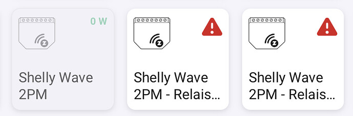

I have just installed Shelly wave 2PM on homey pro 2023.
While 3 devices are added, the relay 1 & 2 devices remain in error. And I see an error that they are still being configured.
I tried re-adding them, restart the app, restart homey. Nothing seems to help. I am running v3.27.2.

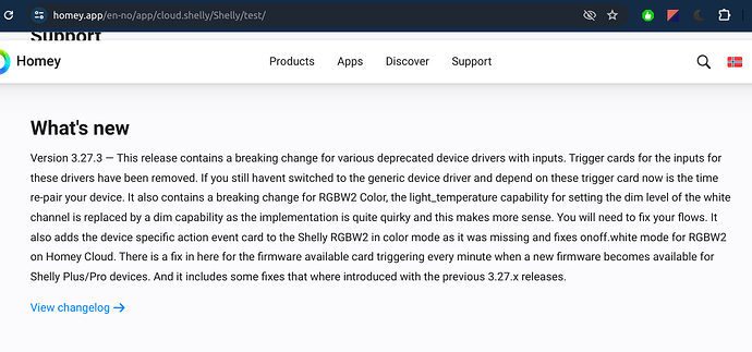

Thatâs a bug in 3.27.2. Itâs already sorted in 3.27.3 but that is pending approval by Athom. You can install the test version manually though.

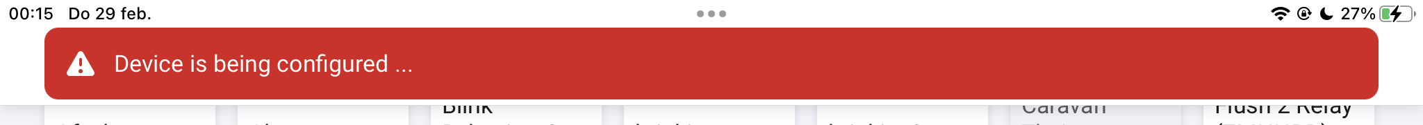

Hi. After Shelly updated there app. My 3 devices stop working. I can install the Shelly module, but both channel are in error⌠âdevice is being configuredâ I tried to reboot Homey PRO and Shelly. I tried to delete and install again, but not working⌠Help please.
Just re-install (no need to delete) the Shelly app. It will install v3.26.1 (at least it did that for me) , and all will be good again. I disabled auto update as well. Had the same problem with the 3.27.x versions. Or you can try the new test version that claims to fix this. Link below:
