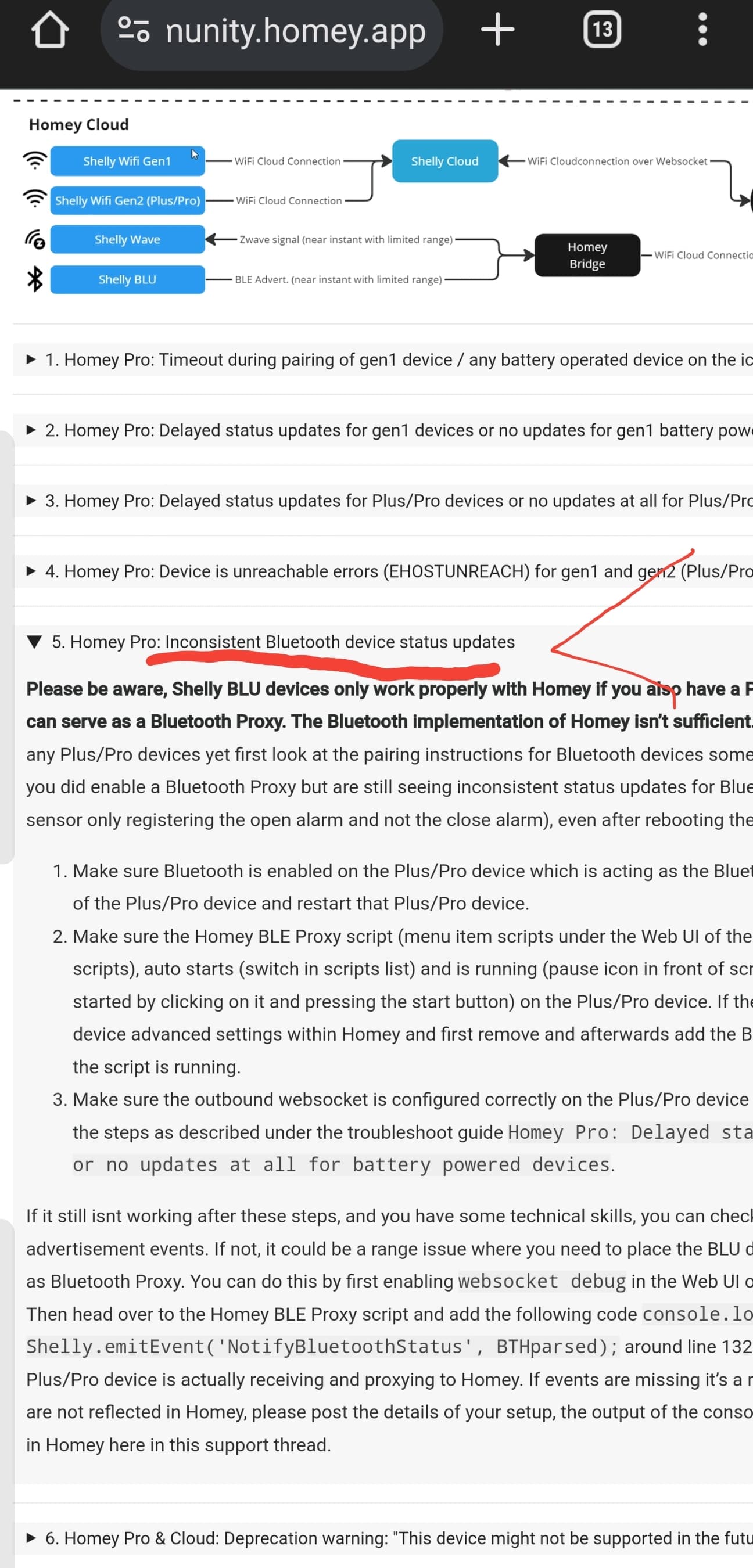

I think Point 5 of the Troubleshoot section of Post # 1 can help you out:
Ah ok I will test with the scripts - I did not integrate them
Thanks, I havenât seen that before. I will try to solve my problem with this.

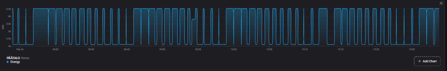

Native Shelly app measure everything right but in Homey Shelly app 3em energy readings are false.
Is the energy measurement in all phases incorrect?
In old 3em (not pro) Homey shows only one device thats sums all phases.

I have so many flows with 3em so i havent tried to add it again. It has worked from begining this way (over one year now). Total power and everything else is right but cumulative energy seems to do something wrong. Can you send a picture from insight of your energy (last hour). Heres my graph:
Some time ago I had to reconnect the old 3EM because of some change in the app. I would recommend that you reconnect the device and try it that way. If I remember right you can add the same device again without removing the current device and that way you can change all the flows more easily to new device.
I have also very large amount of flows that use the 3EM, but in the end it was not so much work to change the flows to use the new device.

Is this happening in the gen1 3EM or the Pro 3EM? On Homey Cloud or Homey Pro? Both should have 3 seperate phases. If it doesnât it has not been added correctly. And what is the name of the capability under the device that is not showing the insights correctly? And what steps from the troubleshoot guide have you already performed including trying to re-pair?

Its gen 1 3em. I have 3 of them. Re-pairing is still left to do. Everything else works perfectly, so havent still done re-pairing. Iâll gues i have to try it next.

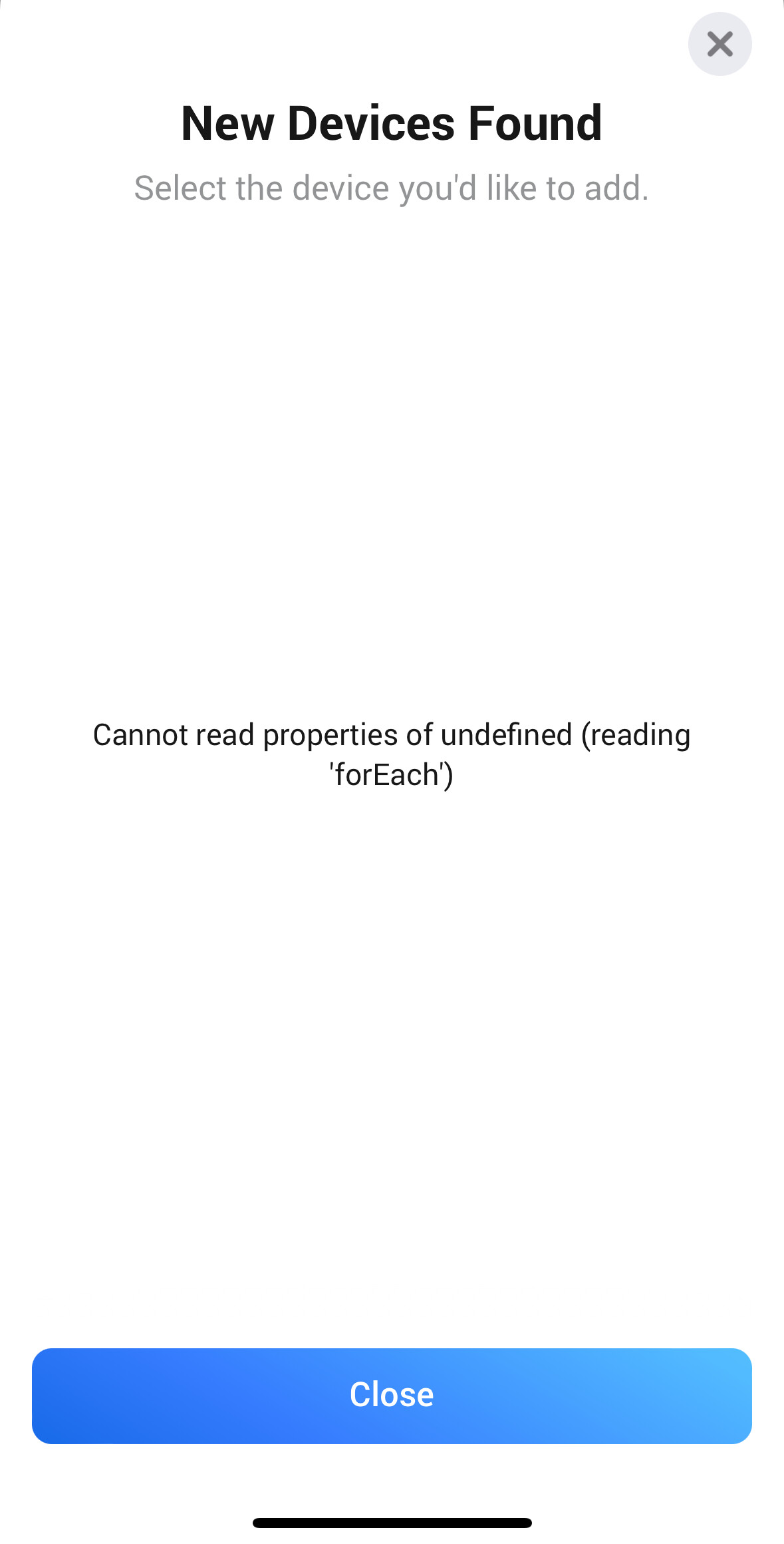

Trying to include Shelly BLU D/W, but the pairing process with Homey Pro (2023) does not even start. Adding device â shelly â any bluetooth device results with an error message. Cannot read properties of undefined (reading âforEachâ)
Replying to myself, as it appeared that the same issue surfaced before as well. A bug in Homey, BT-discovery already running â try rebooting Homey. Now I also remember that this trick fixed the same issue last time.
EDIT: Rebooting Homey did not solve the issue.
I will add something to handle this issue more gracefully and report the issue. But that doesnt fix the underlaying problem where apparently Homey can return a undefined result after performing a BLE discovery scan. Itâs not something I can fix. I would suggest rebooting Homey again until it works.
