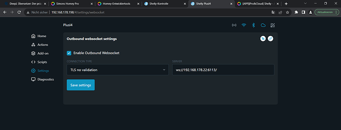

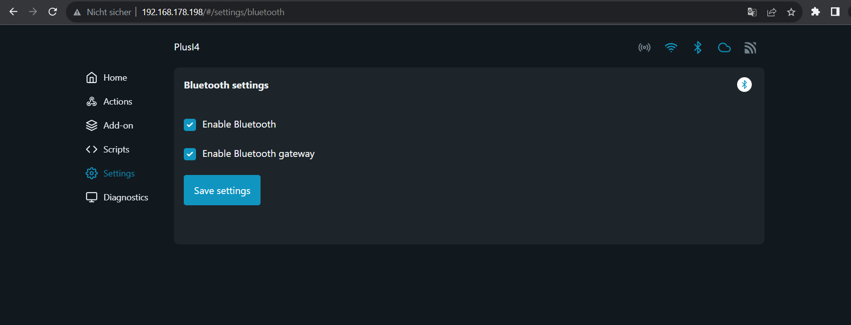

I believe I have now followed steps 1-3 of 6. Homey Pro: Inconsistent Bluetooth device status updates. That should all be correct as seen in the pictures, right?
where is my mistake?
You should enable Bluetooth but disable Bluetooth Gateway.

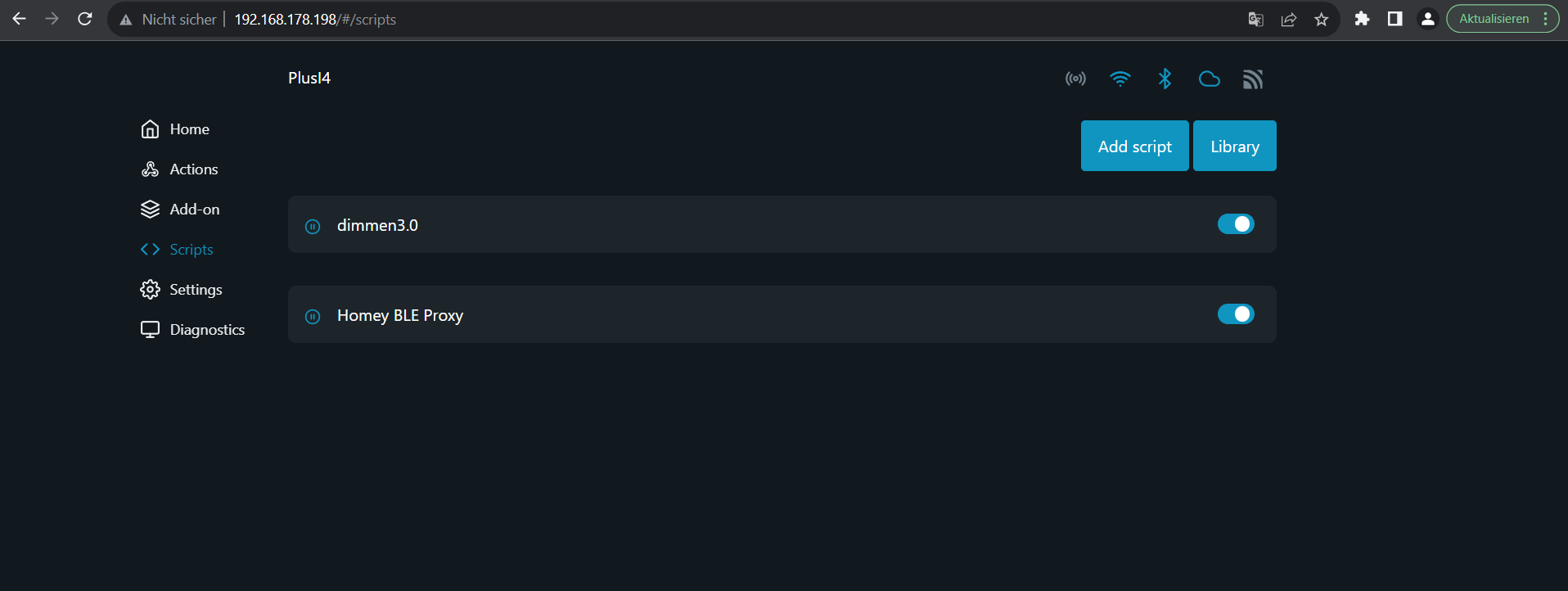

But the script only runs on one pro device for me, do you have any ideas about that too?
Not really. Do we devices have the same firmware? And what is the actual error when trying to run the script.
