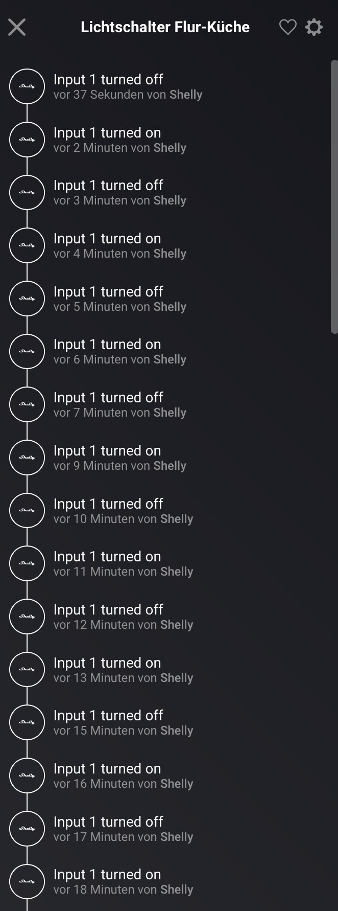

Hello everyone. For a few days I have had the problem that all my SHELLY PLUS 2PM no longer work. I use Detached input. With the second switch, input 1 is switched on or off once a minute. There are no switching operations in the Shelly surface. I have already completely reset and set up a Shelly.
A Homey Pro 2023 with current firmware and current Shelly app is used.

I’m pretty sure this is not caused by the Shelly app but something on your side. The code for changing inputs is used for all devices. If this was a bug in the app other users would have reported it as well. Double check your flows.

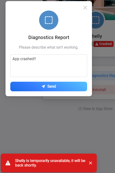

Have same issue. At first I thought the App crashed while adding a new Shelly device.
Removed the app and added it again and immediately it said: app crashed.
Set my homey to factory default restored my backup same issue.
Set it to factory default again and installed the homey pro as new, same issue after installing the app.

Edit: I found an error code, maybe it helps: 1c39ab9e-3645-437e-bc81-a649f0797932
Yes, report it to Athom. It’s yet another bug with Homey which they are aware of but have not prioritized or are incapable of solving. It’s not for me to fix.
And since I get a lot of users sending me diagnostic reports because of this. Is the app is crashing for you, report it to Athom and not me.
