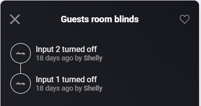

The history is not something I control from the app. Looks like the Shelly has been set up in roller mode. Are you sure you actually changed the device input in the last 18 days?
Everything is automated every day. They close at sunset and open at sunrise. I havenât physically operated the blinds manually for a long time.
Itâs strange how this history is working. Sometimes is not showing correctly that the device was turned on/off by flow. On some other devices, there is no information about the flow that triggers action at all. Those logs are not helpful if something is not working as it should.
Example: (the last two changes are after I noticed that all shelly devices simply stopped updating their status to the homey cloud, everything else is based on flow activation.)

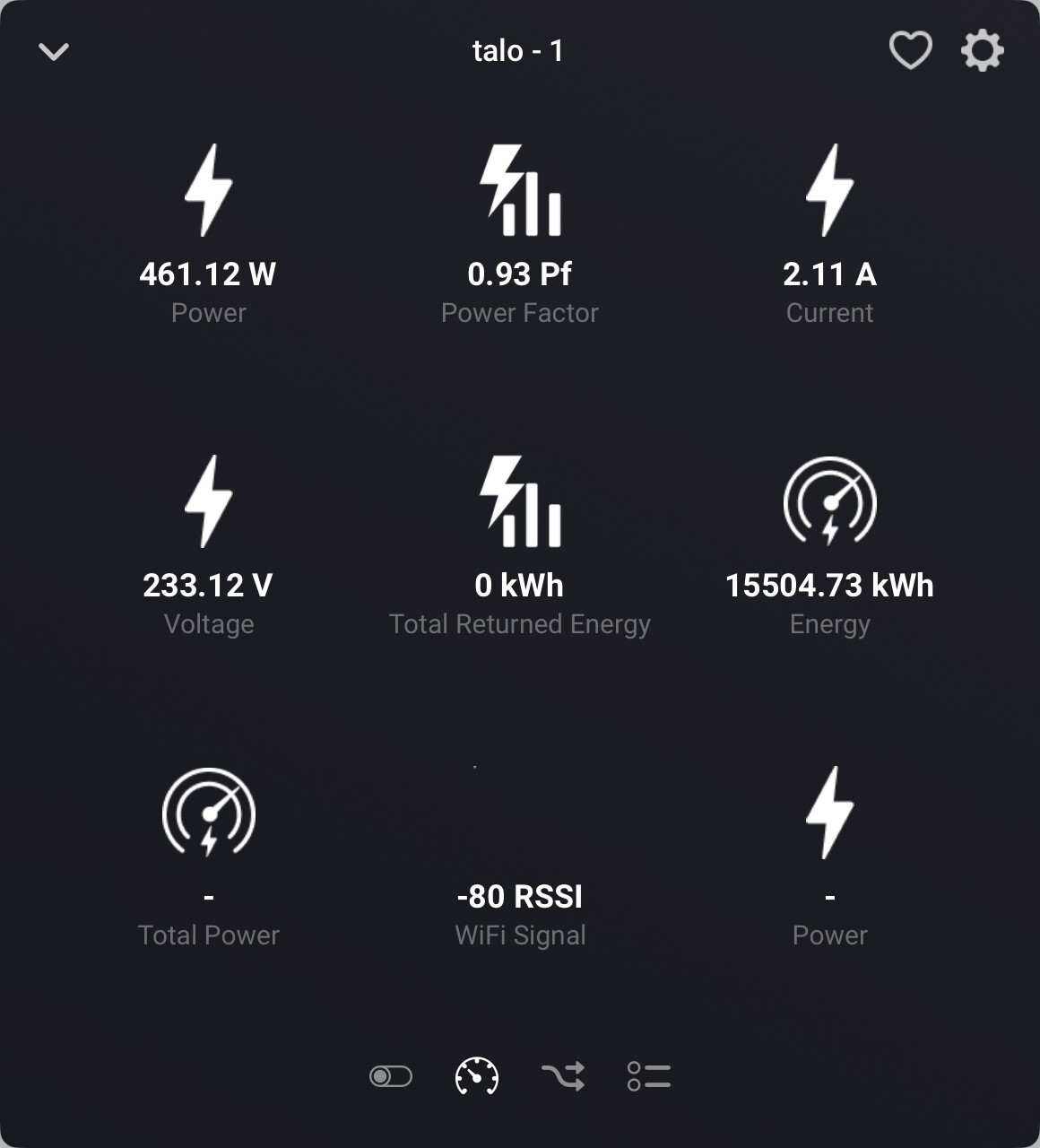

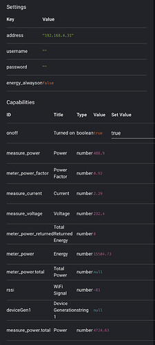

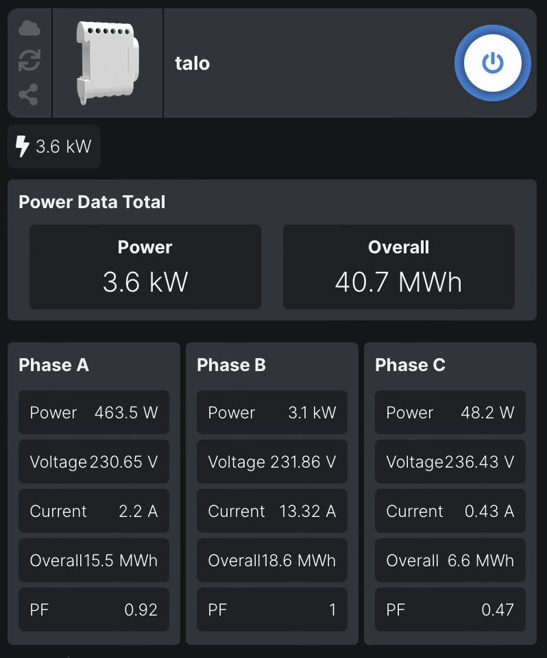

@Phuturist: Thank you very much for the answer. In my case, there is a âTotal Powerâ value for phase 1, but it does not show anything (-). Also on phase 1, there are two times the âPowerâ value in W, which displays different values. One of these âPowerâ values seems to be the Power on phase one, but the other âPowerâ value seems to be an average. In any case, it is not ideal in my opinion to have two times the âPowerâ value in W on the same device, especially if the values displayed are different.
