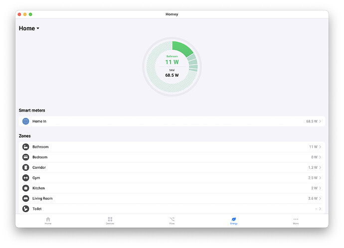

I have a Shelly EM power meter for measure the full consumption of my flat.
I would like to use the data from the shelly device as a full usage, and the other devices as a âdetailed viewâ

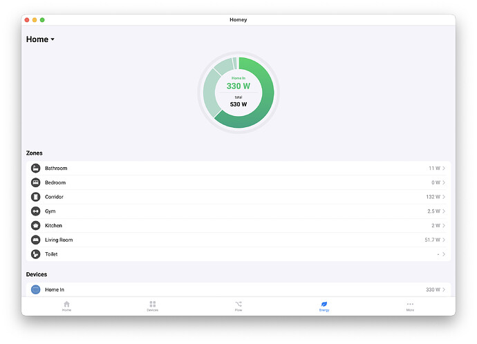

Now in my setup the shelly EM is a part of a full usage, and in this case, i get a really false data as a full consumption.
For example in this screenshot, my full consumption is 330W, and I know what devices use 200W from.

I solved the problem, thank you for your help, i tell you what happened (it can be useful for other users).
So firstly, I tried to repair my EM to homey. if this is the default setting, I thought this will solve the problem, but nothing happened.
As a next step, I created a flow for this as you said, but still nothing happened.

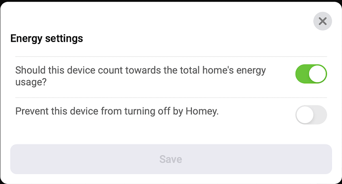

because you said, the device has this function, I started to search in the settings, and i found a solution.
first, I went to the devices - EM - Settings - advanced settings, and I set the âInclude in totalâ as âyesâ
After this, i went to the energy tab and i check again the EMâs settings here. I was surprised, but i got a new setting here.
