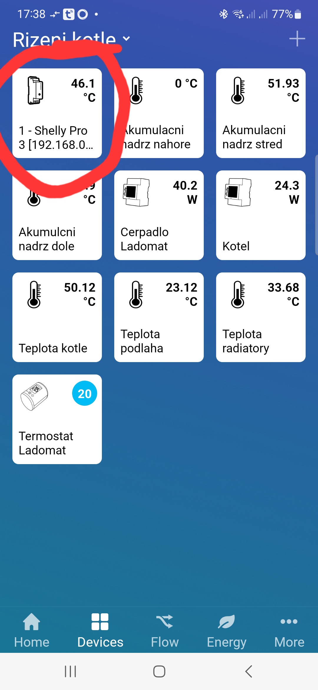

Hi, please have anyone the Shelly PRO 3 unit? It is a 3 channel relay switch module (dry contacts).
I installed it today. In Shelly app works everything fine. But if I add it to Homey i see only one channel. I have also the Shelly 4PM unit this unit shows in Homey 4 Independent diveces, but this PRO 3 only one. Any help?
1918489
Have you tried removing this channel 1 and just re-pair it again. Might just have been a glitch during pairing.
Ok that’s working :grin: after i deleted the one and restarted the Shelly app and tried again it added 2 channels after repeating the procedure once again now i have all 3 channels. Thank you
