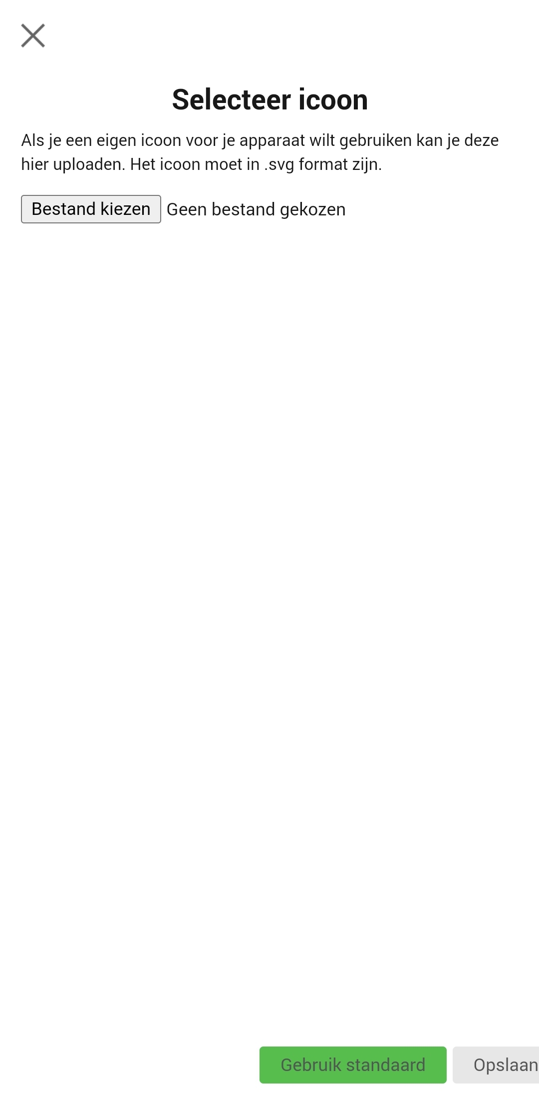

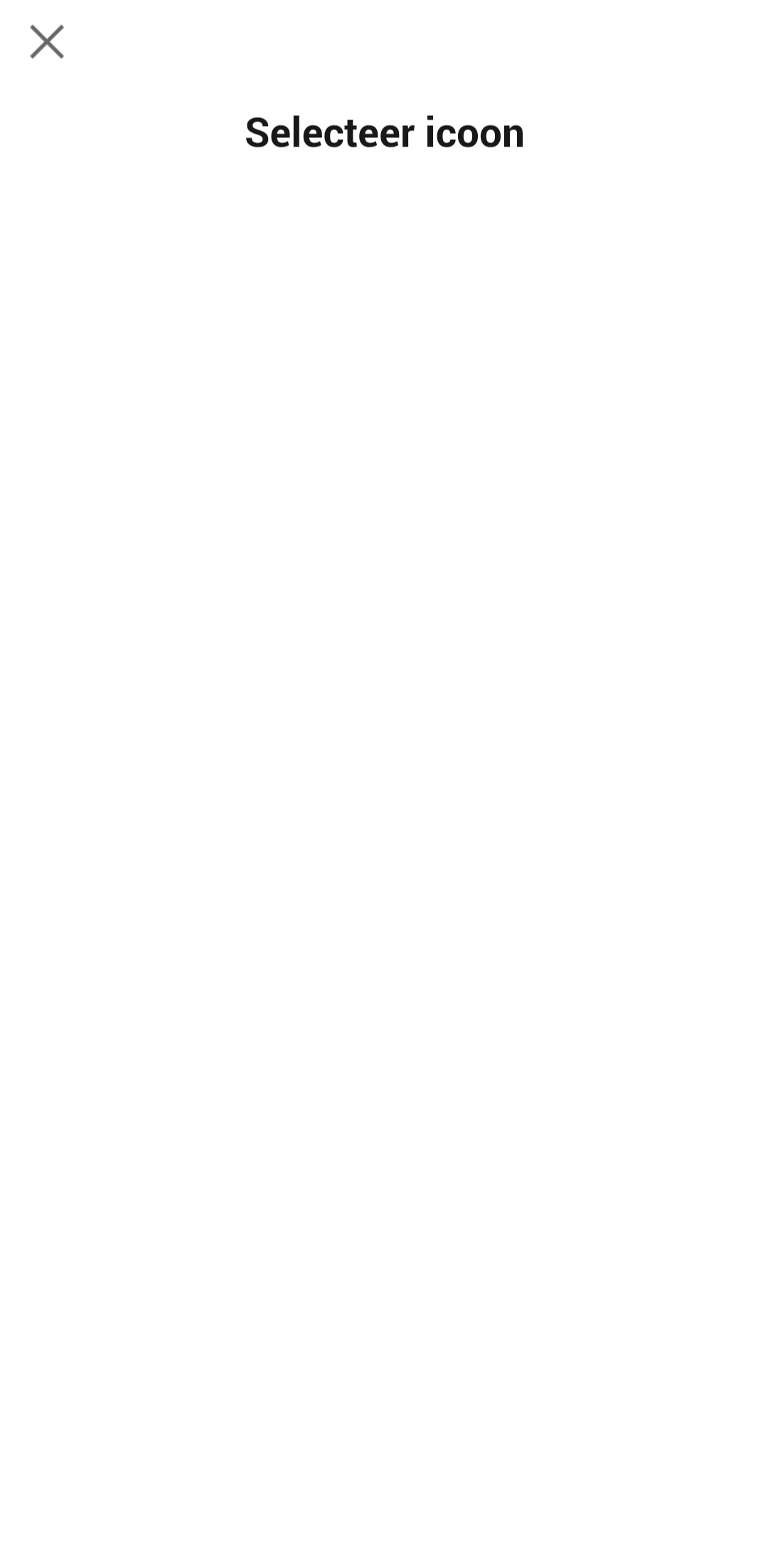

I cannot add my new Shelly H&T (Humidity & Temperature) WiFi Sensor.
On both the Android app and the web (homey.app) I get a black screen with “Selecteer Icoon” after selecting “Gebruik standaard”
You can try and send me a report but I doubt it would be useful. Just give it a go.
Read the pairing instructions in the first post and follow them to the letter.
I’ve updated the new device (and other Shelly devices).
It finds the new device fine. But after selecting “Gebruik standaard” or even picking my own SVG-file, I cannot get past the next screen. It is blank with “Selecteer icoon”
