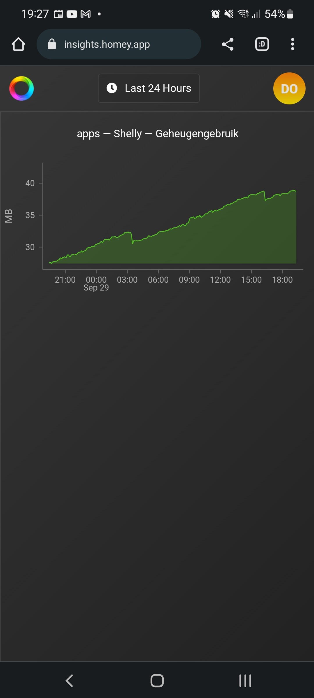

A small update ±24 hours after installing the updated app:
Hope this helps!
Daan201
Thanx, seems these changes did not fix the memory leak unfortunately. My hunch was incorrect. Dont know where to look now.

I’m having the same issue that every so days I have to restart the Shelly app. Would it help if I also send in a report when it happens?
I have 17 Shelly’s atm, multiple 1+pm’s, several Shelly 25 and a regular Shelly 1.
Haven’t checked memory usage so far, just checked this post again since having the issue for couple of weeks now :slight_smile:

Probably not, the diagnostic report does not contain info related to memory usage. But you could try and send me a report when memory usage is over 60Mb perhaps there is something in there.
