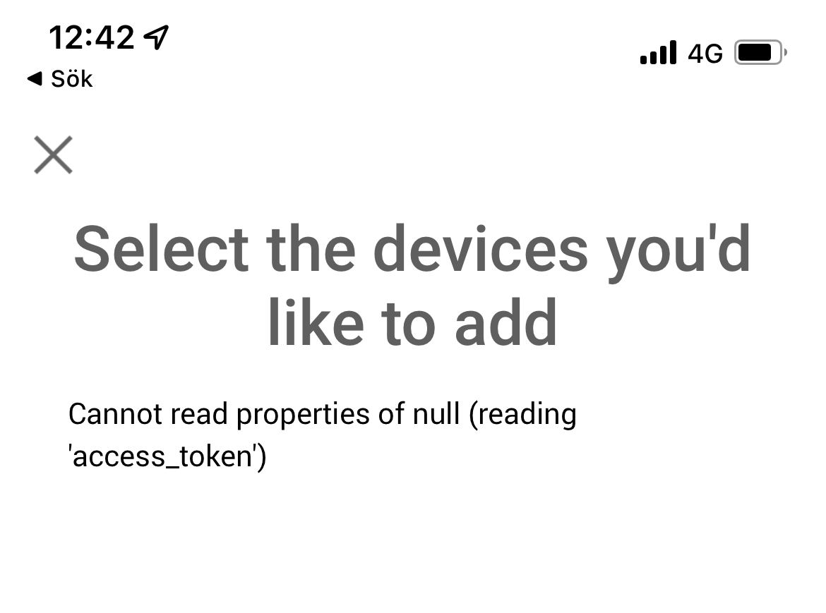

Using Cloud/beta. Shelly stopped working for me a couple of days ago, probably when app updated. Only have non plus / pro devices. When I try to add devices I get message in pic.
Probably missing something simple but what ![]()

Doesnt look simple at all. The error originates in the OAuth2 module from Athom. It looks like oauth2 authentication wasnt succesful but I can not reproduce. Try pairing the device using the web interface with an incognito tab. This will force a new oauth2 login and should refresh the access token. Another thing to try is temporary install the test version of the app. This will force an app restart and might also clean invalid oauth2 sessions.

Tried web app incognito tab but got same message. Can not install test version since I am on Cloud/Beta. Tried reinstalling Shelly app but that did not help either.
Next step uninstall Shelly app and reinstall or any other suggestions?

Do you have to enter Shelly Cloud login credentials when trying to pair devices? And if so, do you actually have cloud enabled for any Shelly devices?
I can see the login to account screen for like a millisecond before getting the error message. Have cloud enabled for all devices and it works good from the Shelly app.
Have you recently changed your Shelly Cloud login? It seems itâs trying to auto login based on an existing oath2 session which fails and which is not handle correctly by the oaut2 login module of Athom.
What happens if you first go to my.shelly.cloud and login there? Itâs not that actual oauthw endpoint but perhaps that clears the invalid session.
Have not changed my password.
my.shelly.cloud works fine but it does not help with Homey, same error message.
Only change I have done recently is a flow that restarts itself and works as a timer. Could it be that Shelly does not like that and has kicked me out?
