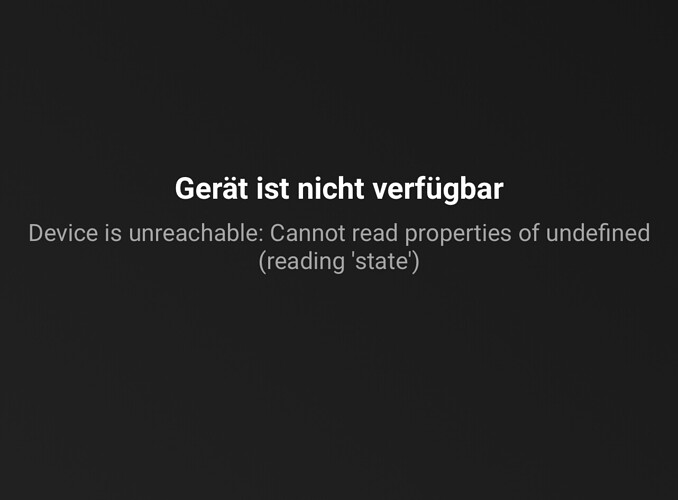

@Phuturist Hi I don’t know what’s going on but after the new version nothing is working.
Homey can read status of the Shelly actors but can’t turn on or off anything ![]()

Follow the troubleshooting guide from the first post in this topic. Also, according to the log you send me you have dsiabled CoAP in the app settings. Any particular reason for doing so? It will prevent near real time updates from Shelly devices in Homey. If you didnt know what you where doing when you disabled it you should renable CoAP again by unchecking the box in the app settings.
[EDIT] And restart the app or even better, Homey afterwards.
The second Channels of shelly pro 2 din‘t work after the Last update. It is the same problem as the 4pro described above. Restart of Homey Ort the Shellys Don‘t help ![]()
The first channel works Fine.
