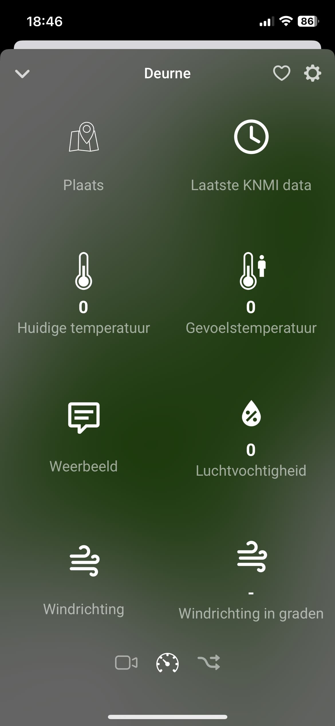

@LRvdLinden since tody the knmi app stops working and displays no data
After a restart it wordks for a short period of time but then it stops again.
Until today it worked fine
Any clue? Homey 12.5.0, app v4.0.2
Same issue here. It seems to relate to today’s values only. After I set my location again and restart the KNMI app, the data is available again for some time. However after the next data update, they are not available anymore.

Okay found it.
I need to contact our api partner about it.
Liveweer Data:
fout: ‘Dagelijkse limiet van 300 verzoeken overstegen. Meer nodig? Neem een pro-abonnement voor 500.000 dataverzoeken (€45 per maand) bij https://meteoserver.nl’

I have made a temporary workaround. Every 15 minutes I check whether certain values from KNMI are zero (current temperature and current real feel). If both are zero, I restart the app. Then it works again for some time and my flows (including screens for the sun) continue to function.

Since a few days I also see 0 (null) or empty values for the current data (Huidige temperatuur, Gevoelstemperatuur, Luchtvochtigheid, Douwpunt, etc.). I’m sad about it, because this app is really useful for me to give me a sign on a warm evening when it’s time to open the windows.
Changing the language or re-installing the app helps only for a few minutes.
