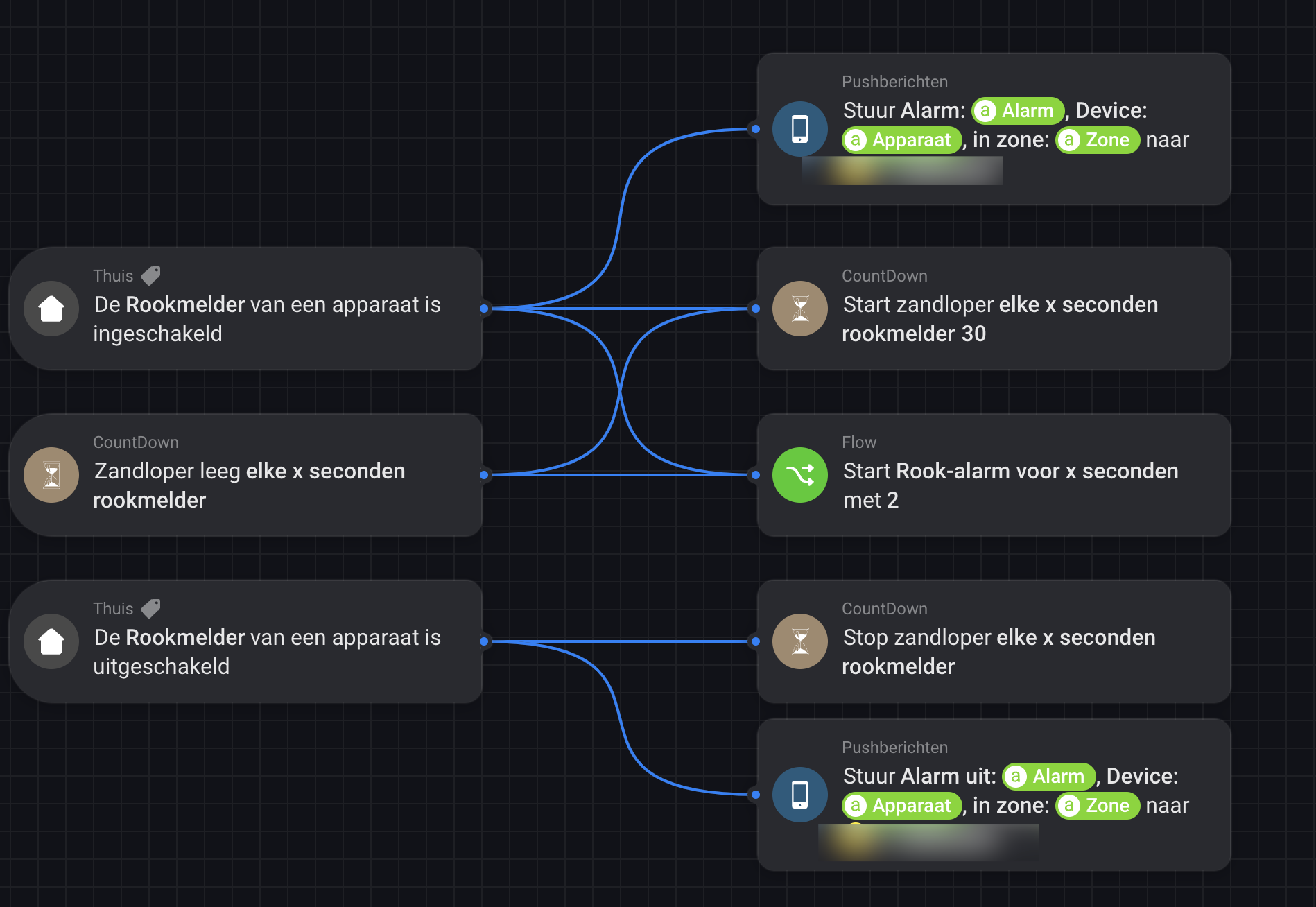

I’ve tried to solve it like this.
When an alarm goes off, let all other alarms alert 2seconds every 30 seconds.
The real-alarm keeps beeping, in the time the others don’t make noise you can hear where the ‘real’ alarm is comming from.
When the alarm is turned off, the timer is cleared and the others don’t alert anymore
As far as I know you can see in the app which alarm started, at least if you send messages to the timeline.
And If you send fire alert messages as push messages to your phone you don’t even have to open the app.
