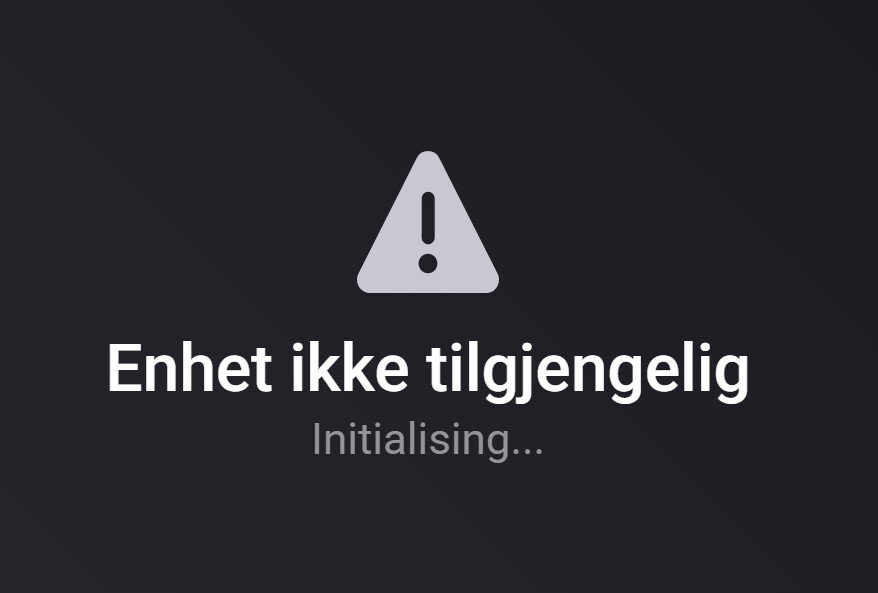

I just added a siren but it's stuck on this
with an exclamation point. I have also
run the standard routine of resetting
the device by holding the button down for 15 seconds.
Severalt times.
@krl69 An update to the Frient app will be released today (evening) that will solve this issue.
Nice, thanx!
The initialization issues should be fixed with the release of 2.6.4 version of the Frient app.
The cause of the issue was not related to the latest app update, but triggered by a change in Homey SW (12.8.2), which was released to stable a few days ago.

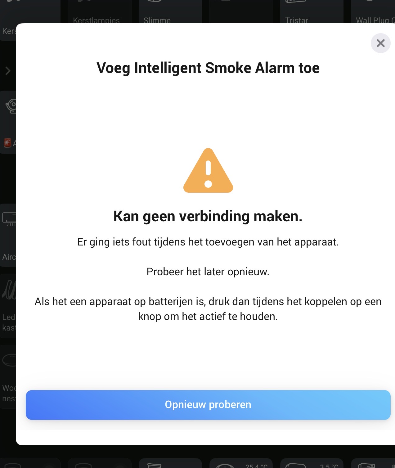

I grabbed a FRIENT heat alarm and a smoke sensor, and it has been a real struggle. Unless there is something that I don’t know, these are the worst devices I have seen so far. At least they have alarms, so they are not completely useless and can be used as dumb sensors… any help would be very much appreciated…I’ve had 0 success PAIRING THEM!
