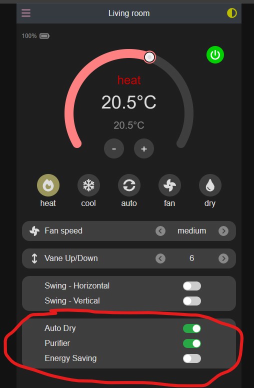

Additionally, would it be possible to also add the three options highlighted in the image below:
  • Auto Dry
  • Purifier
  • Energy Saving
I hope this feedback helps improve the LG integration. Thanks in advance!

Thank you for the reminder and the patience! I’ve pushed v0.9.0 to testing now, which addresses pretty much everything you asked for: except for the ā€œvane mode: autoā€, because it’s not available in the ClimateControl :frowning:
I’ve also added the Silent Mode toggle for MHI.
HOWEVER: I own MEs which do not support any toggles, so I have no way to verify whether the toggles actually work and/or are even shown. But hey, the code compiles, right?!
Please let me know if you see the toggles, and preferably if they work :sweat_smile:
