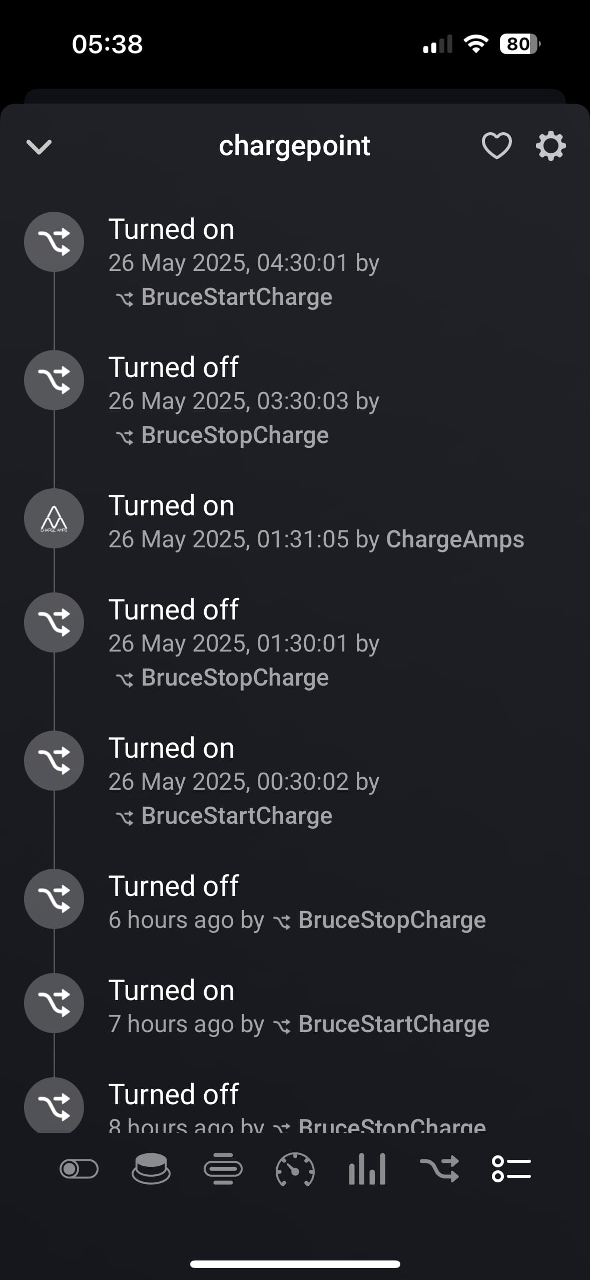

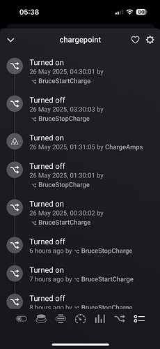

Any idea what could have turned on my Halo at 01:31? I do not see anything on the Timeline, and from the attached picture from the device, it looks like no flow, but the app itself?! Like if pressing the button in the app?
I was sleeping, as well as my phone.
I have a feeling this might have happen before.
This time it let the charging continue one extra hour, disturbing my Power tariff strategy…
