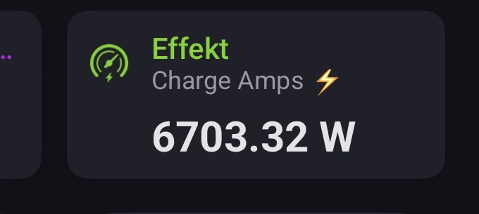

Might be a something or nothing :slight_smile: New test version rounds off effect value. It still does the job.

Thanks for all your testing, I will dig into the issue @Steven_Bareman reported in coming versions, its a bit hard to determine what value that actually are correct, especially when there are several different values that should display the same thing.
Don’t know if my App shows an incorrect value or not, the App itself doesn’t ”invent” the Numbers it just collects them from the ChargeAmps API. But not saying that you are wrong @Steven_Bareman , I will dig into this and see if I can find anything.
I don’t want to disregard of the things you have found, they will be addressed. But you have provided vital feedback, the App works and no major problems have been seen so far which is good.
