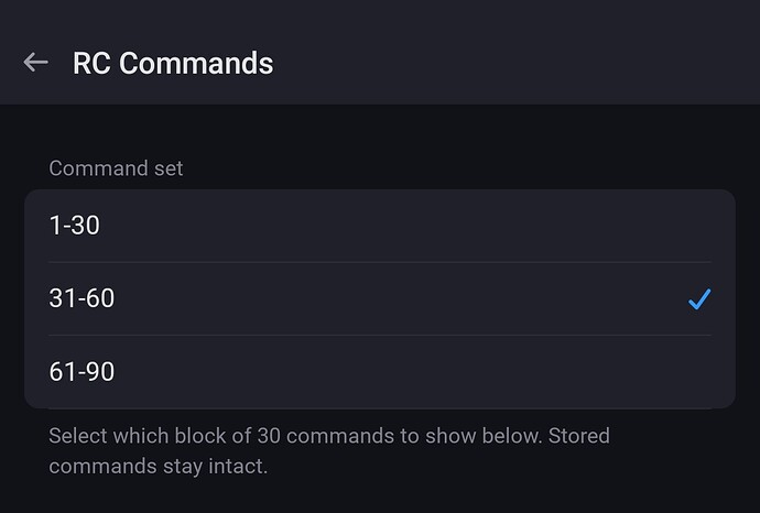

Based on your screenshot I’m not exactly seeing what you are:
When I select “command set“ I can choose the sets…
… but when I go back I’m still at command set 1-30. Do I first need to fully populate the first 30?
You need to apply the settings. But the learning shall continue incrementally no matter which set is selected, it’s for editing of the commands name only.

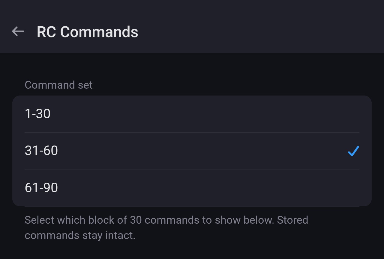

Right right, thanks again. Unfortunately I didn’t get to testing and loading all the commands in yet. Work got in the way. But this is the current behavior on my side.
1000001981
Strange, can you send diag. log?
e99cfabd-c602-40d8-98d5-f339a73ba72e
Edit: maybe I should have mentioned that I’m seeing the same behavior when I try to switch between sets in the Homey web app.
Please try new test - Broadlink | Homey - in case of issues, let’s continue 1:1.

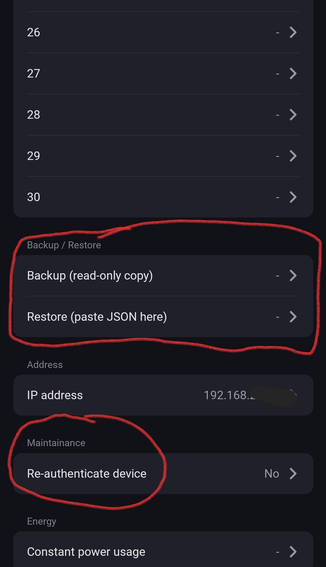

the other anyying thing is when I uninstall till it looses all the remote control I have manly put in to home is there no way of backing them up so you dint need to keep on manly putting them back in
I just read a few posts earlier there’s a backup/restore function added to the app, Richard.
Awesome! Both additions are very welcome!
(I just discovered the backup/restore function :face_with_peeking_eye::grimacing: )
