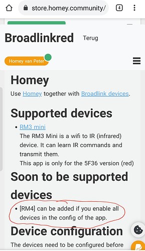

I get the error: Ander apparaat gevonden: unknown (653A) - I have a RM4 Mini - Device: 2aCDZ-BL3336-P Can this device be added? Tried multiple times to add the device in linked condition, but also closing the app when adding a room. Please let me know how to fix this. Thanks
The RM3 mini is supported, the RM4 mini isn’t afaik.
But,
You could give the Broadlink community app a go.
Rm4 mini works great with the app from community store
can you send me a link of that please?
https://store.homey.community/search?q=broadlink&t=1634737335827

I can click the install button for the Broadlinkred app on the Community store, but the app doesn’t appear in my Homey Pro. Does it take hours to install?
Trying to get my Broadlink RM4 mini to work with Homey
No it shouldn’t take more than a few minutes.
Did you install the community store first?
Use a pc / laptop for this
https://store.homey.community/hcs
If that went well, logon to the hcs site
And search for your wanted app.
Now the install button should been green instead of grey, and the installation should succeed
Thanks! Switching my phone to desktop mode worked. Everything else I’d done yesterday.
