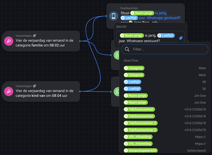

I tried to make an advanced flow with multiple starters, but the tags that are generated are double. So if I try to include a tag in a birthday wish, I get 2x name, 2x number etc. I can circumvent the problem by making a flow for every starter. But maybe you can fix it so that all starters start the same tags?
What you are seeing is correct.
These are the tags of both triggercards. Which happen to be identical.
But there’s a trick to discover to which triggercard the tag belongs: the triggercard will glow blueish, and the tag color changes from grey to blue, when ‘hovering’ the tag with the cursor.
Thanks for the tip! It works perfectly!
