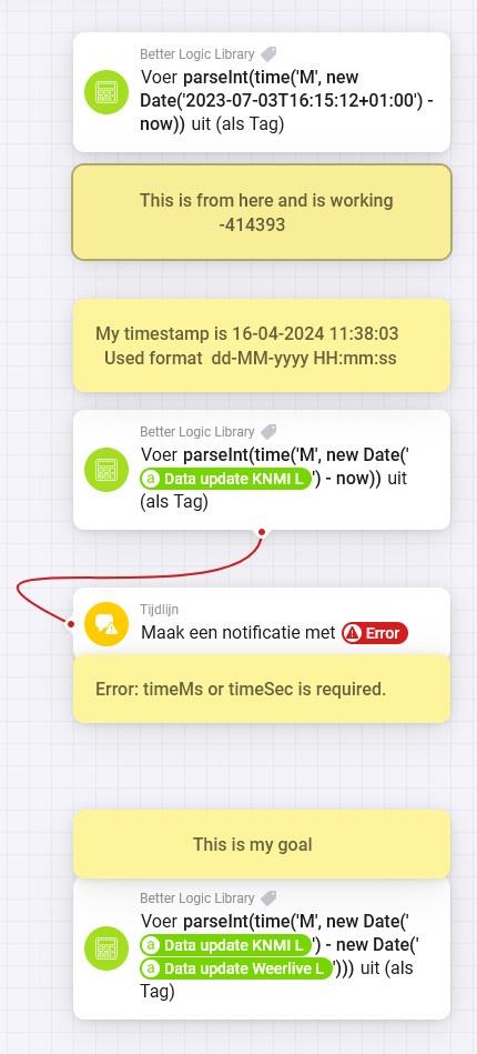

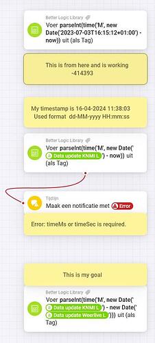

How do i get the Unix or Epoch time to use as a tag? Previously I’ve used $timenow$ with a mathJS card but I’m trying to use the BLL card to a GET Request as it needs the current time in 10 digits.
I found this working script, but I can’t get it to work as BLL function
function epoch (date) {
return Date.parse(date)
const dateToday = new Date()
const timestamp = epoch(dateToday) console.log(timestamp)
Hopefully is the picture clearly to understand.

The formatting differs
First timestamp has this format:
yyyy-MM-ddTHH:mm:ss+01:00
The “KNMI” timestamp has this format:
yyyy-MM-dd HH:mm:ss
I think you first should convert your “KNMI” timestamp to that format, then I don’t see why it should error;

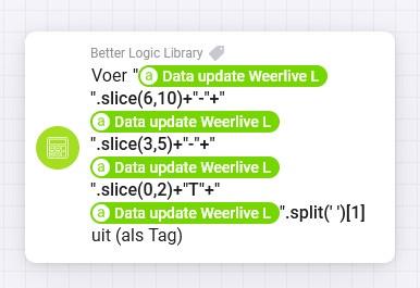

Edit 2
By putting split(’ ') in the search I came to .slice( , ).
The input = 16-04-2024 21:38:03
The output = 2024-04-16T21:38:03
Now the variables with only the time I will let go otherwise I have 2 x 3 needed.

My goal in post 144 is sadly not there.
The parseInt to ‘now’ worked for both date.
Unfortunately the difference between the two is not yet clear.
So now or then it’s working but mostly not.
The error is then the same as in post 144.
For now :sleeping:
Edit 4
Finally I found why I was not getting a 0 out of that formule when I replaced ‘now’ with in the exact same way with the other value.
Then I try to put ( ) around every parseInt(time('M', new Date('2023-07-03T16:15:12+01:00')
That make it then this:
(parseInt(time(‘M’, new Date(’ Data update KNMI ISO’)) - (parseInt(time(‘M’, new Date(‘Data update Weerlive ISO’))))))
