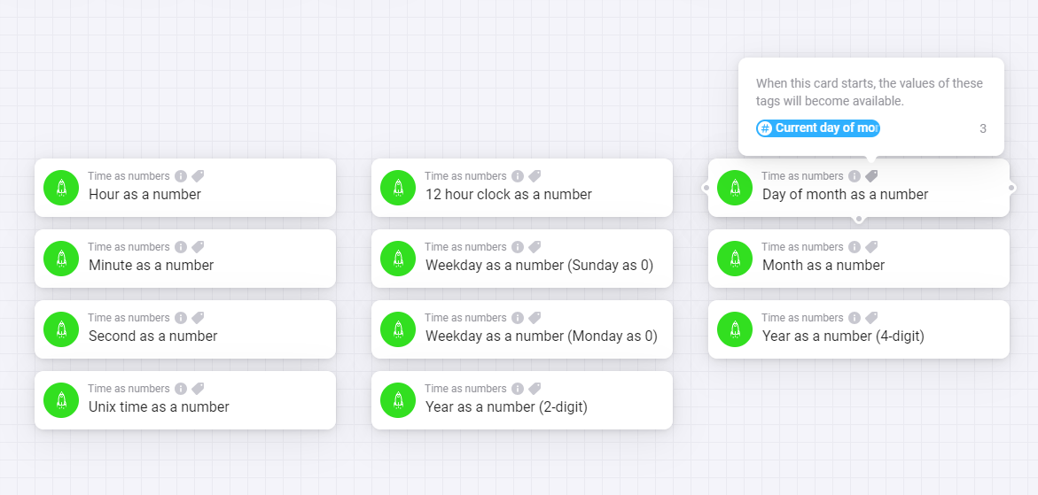

Hi @Arie_J_Godschalk
I needed to get the current hour as a tag so i started to build a app and added other things I thought could be useful for someone.
I made a lot of flowcards.
It looks like this
But i got problem that it showed 1 hour wrong and after reading a bit I read in a thread that you recomended using BLL.
Im not that good programmer in javascript so i was thinking you might include this feature in BLL.
Personally I only need the swedish hour so im fine with my app not published, but someone else maybe needs to do calculations on time or something.
/Rikard
I think most options are already build into BLL.
You can use the BLL expression as Tag flowcard and fill it with, f.i:
parseInt(date('hh'))
maybe it is, but that gave me the time 12 hour off.
Im still not that good programmer to guess how that works.
thanks anyway
/Rikard
@janrikard Ah, sorry, use capital HH, if you want 24 hour based.
See the BLL app settings for all examples. :slight_smile:
thanks, that works for me.
I should se if i could solve this in my code so users can get this without you have to give personal support
/Rikard
I can add a flowcard to retrieve date-parts as number.
It wouldn’t need this many flowcards, just a pickerlist with all the date-parts that BLL supports.
I would appreciate that and I think other users with even less programming skills could use it.
/Rikard

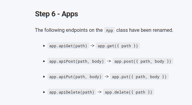

HomeyScript (New Api) and Better Logic Library
Does anyone know how to read and write BLL variables using the new, latest Homey API?
Old code:
// BLL
var testStr = “1.01,1.02,1.03”;
let BLApp = await Homey.apps.getApp({id:“net.i-dev.betterlogic” });
log(BLApp);
BLApp.apiPut(‘TestStr/’ + testStr);
Script Error
Type Error: BLApp.apiPut is not a function
Maybe it’s not possible. (Yet) :slight_smile:
Thanks!
Please use the topic for Homeyscript testers, I would recommend discussing issues with topic starter Jeroen (Athom), and read the updated docs posted there, thanks!
But, while I looked it up already, this might fix it, Johan; it seems like apiPut has to be replaced by put
Screenshot from 2024-05-13 20-27-12
Ah, excellent!
Thanks!
