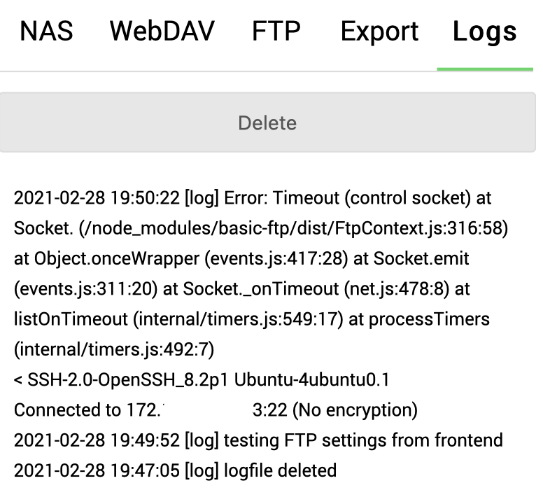

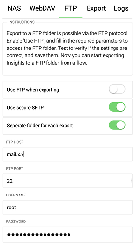

I’m experiencing some problems logging in to both SMB and SFTP :frowning:
On SMB it will thrown an error directly if I enter the wrong credentials. But if I use the correct credentials and test, it will just return a message saying “Error” after a while. Assuming it is some kind of Timeout, but nothing is shown in the log…
On SFTP I always seem to get the “Error”, no matter if I use correct credentials or not, but at least a “Timeout error” shows up in the log.
I notice that the log says something about being connected (No Encryption) is this part of my problem?
I have tested 2 different SMB servers (both Macs), and 2 different SFTP servers, 1 internally on my network, and another one out in the wild open.
I have tested both IP and fqdn for all connections, and I am able to access these servers from my MacBooks.
What can I possibly be doing wrong here?

I just tested SFTP myself with a drivehq account. I have no problems. Are you sure your FTP host supports secure FTP? And are you sure you entered the correct port? I have to use port 21 for secure FTP with drivehq.
I also just tested with SMB on my NAS. And also there I have no issues.
That doesn’t mean there isn’t some problem in the app. It just means I cannot reproduce the issue so it is kind of hard for me to debug if the problem is indeed in the app. I am willing to try your settings on my Homey, but you would have to share your login credentials with me and the SMB/FTP hosts must be available on the internet. Give me a DM if you want to try this.

I found out what the issue is for FTP. There are apparently 2 completely different ways to secure FTP.
The FTP package I use in the Homey app supports FTPS, but not SFTP. Your server is doing SFTP, but not FTPS.
It would be too much work for me right now to dig into supporting SFTP. Maybe you can set your server to support FTPS? Or use a free FTPS server like drivehq (5GB free storage).
I’m still in the dark why SMB also doesn’t work for you.
