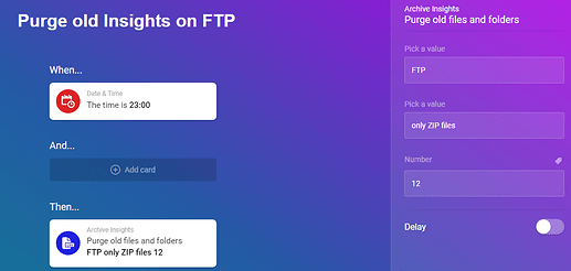

Would anyone be interested if I add (S)FTP as export location? Please let me know if I should spend time on developing this.
New version 2.4.0 is pending approval in the appstore.
Besides some package/security updates, there are 2 major new functions:
  • FTP is now added as possible export location next to SMB(NAS) and WebDAV.
  • Auto-purge of old export files is now possible for FTP and SMB.
Auto-purge means you can make a flow (e.g. every day at midnight) to delete all files that are more then X days old.
BE CAREFUL WHEN USING THE AUTO PURGE
(it will delete files and folders in your archive folder :slight_smile: )
