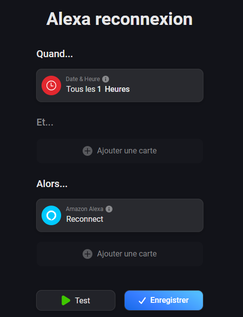

Hi, I also have lots of deconnexion with alexa but I think the problem isn’t Homey but Amazon servers.
Si i’ve made a flow which “reconnect” my alexa app each hours.
It’s a simple flow and since I’ve made it my alexa app work much more better.
I hope it could help you :slight_smile:

| Renaud_Climent
October 3 |
Hi @Chris_Starkey this app works for 99% of people, but how long it stays connected varys wildly per person. A lot of people get months before they disconnected - personally I get about 5-6 weeks, others weeks and some get days. BUT if you are a person who gets “months” then what we see is that you ALWAYS get months.
If you are a person who gets weeks … then you always get weeks, this makes it pretty obvious that is something to do outside of the application. I suspect something to do with homeys internet connection.
As people who reboot their router daily … get disconnected daily.
That all said there are workarounds
  1. Have a look at your router/wifi set up and see whats going on there in regards to Homey
  2. The Flow for reconnecting.
  3. Restarting the alexa app every 24 hour hours will also force it to attempt to reconnect with its existing cookie.
  4. A good way to test to see whats going on is … when you reconnect are you asked to enter your username/password each time … or can it just reconnect using the old auth token? (ie no user/pass)
