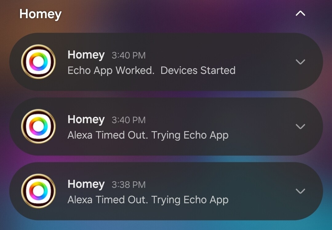

Certainly annoying but at least there is a workaround for some things - mapping command cards of the other Echo app to the error output of this app’s cards is working for me now. But, of course, you need to set up new cards from the echo app instead.
Amazon Echo | Homey
So far its been running ok. Won’t get my hopes up yet as it sounds like it was a change to the API. I’ve been using an Ikea Symfonisk (sonos) speaker for announcements in the house as well. only used the sonos/amazon echo for anything critical like house doors open or garage left open as a backup. Unfortunately i only have the one speaker and missed out on buying more before they were discontinued. Hopefully black friday sales i can pick up a sonos speaker or 2 for cheap.
I’ll definitely have some sort of backup in place as i use speakers to deter intruders/unwanted animals within my property. this is probably the first time ive had it gone down for this long. just need to find the time.
thats interesting the way you have the notifications come up @DJG3. might include that in my setup :slight_smile:

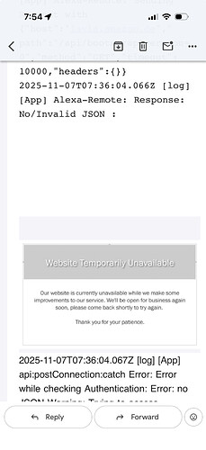

That’s what I’m getting when I’m trying to re-connect
Correct. Tried on the homey app. Connected to wifi but on a different vlan/wifi to my IoT. It should have access to the IoT wifi/network at home. Will try again later tonight and over the weekend.
I have the same error :pensive_face:, same wifi.
Just tried 6.0.1 same error
20054561-0010-4c16-b6cd-015095dbb106
I had a look Kath, yep that’s the flakey error - give it a minute and the try to reconnect - then wait 10min and try again.
What’s happening is Amazon is sending back a webpage saying down to maintenance instead of the (json) connection string - but there is no rhyme or reason behind when it shows ..
