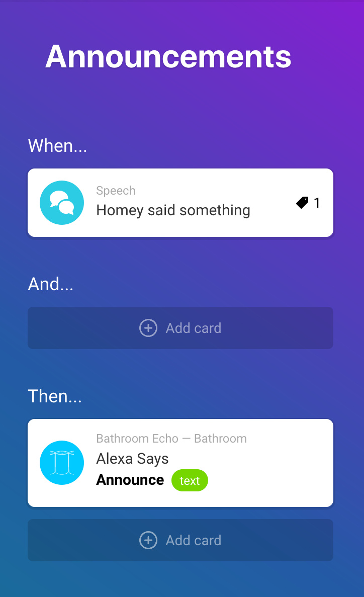

Wait. That “text” tag. Does that mean that Alexa can say what homey just wanted to say? Btw. Those voices. They are homey voices right? Those 27? :o

Yes, using the text tag you can make Alexa say what Homey is saying.

  2. Alexa speaking/announcing the "Let Homey Tell you When) -(already possible intercepting using a flow
