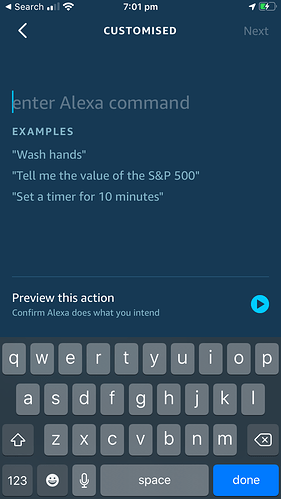

Good news everyone, Amazon have I implanted “custom commands” as routines you can now have a routine that does anything you can ask Alexa
As far as I am aware only available on US accounts at the moment
Correct, EU servers don’t have this option yet, hopefully soon
