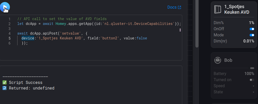

It works here when I use the device name
let dcApp = await Homey.apps.getApp({id:'nl.qluster-it.DeviceCapabilities'});
// API call to set the value of AVD fields
await dcApp.apiPost('setvalue', {
  device:'1_Spotjes Keuken AVD', field:'button1', value:false
(The button gets set to Off or On position, but the actual lights is not turned off or on)
Peek 2023-07-06 01-03
