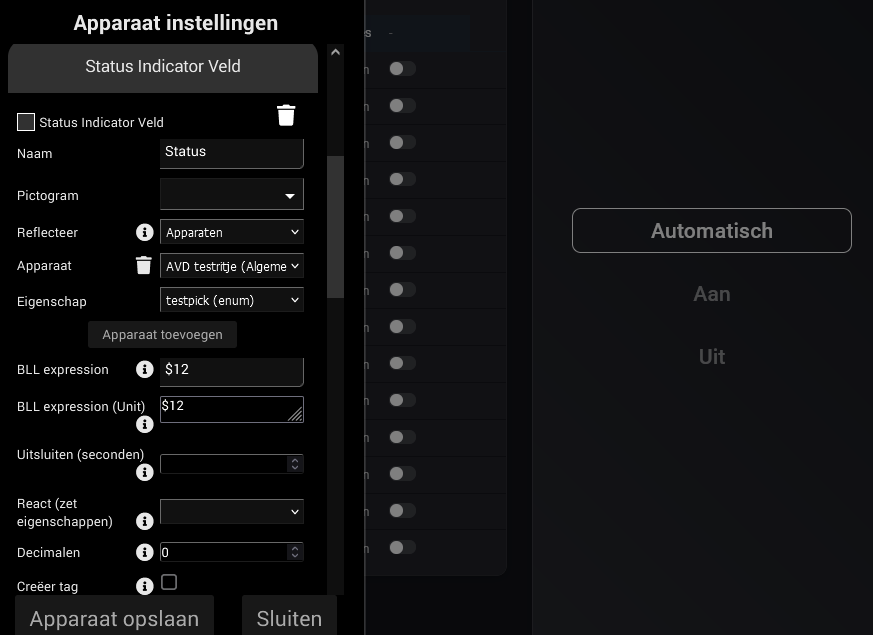

Dear Arie (or reader) maybe you can help me a bit. I try to set up a AVD with a picker list. (I did a request for a specific list). In my test ADV I would like to have the picked value in the status indicator field of the tile. But, in order to do that, i apparantly need a BLL expression to format the field for text (if I understand correctly). Here a screenshot of the settings of the Status Indicator Veld so far… Its a trial ADV called “ADV testritje” and I use a provided picker list (Automatisch, Aan, Uit)
I am a total nitwit in programming-language and I have no clue how to get a standard BLL expressie.
I did instaal thet BLL app, but how to get to the library riddles me. Is there dummies way to help me?

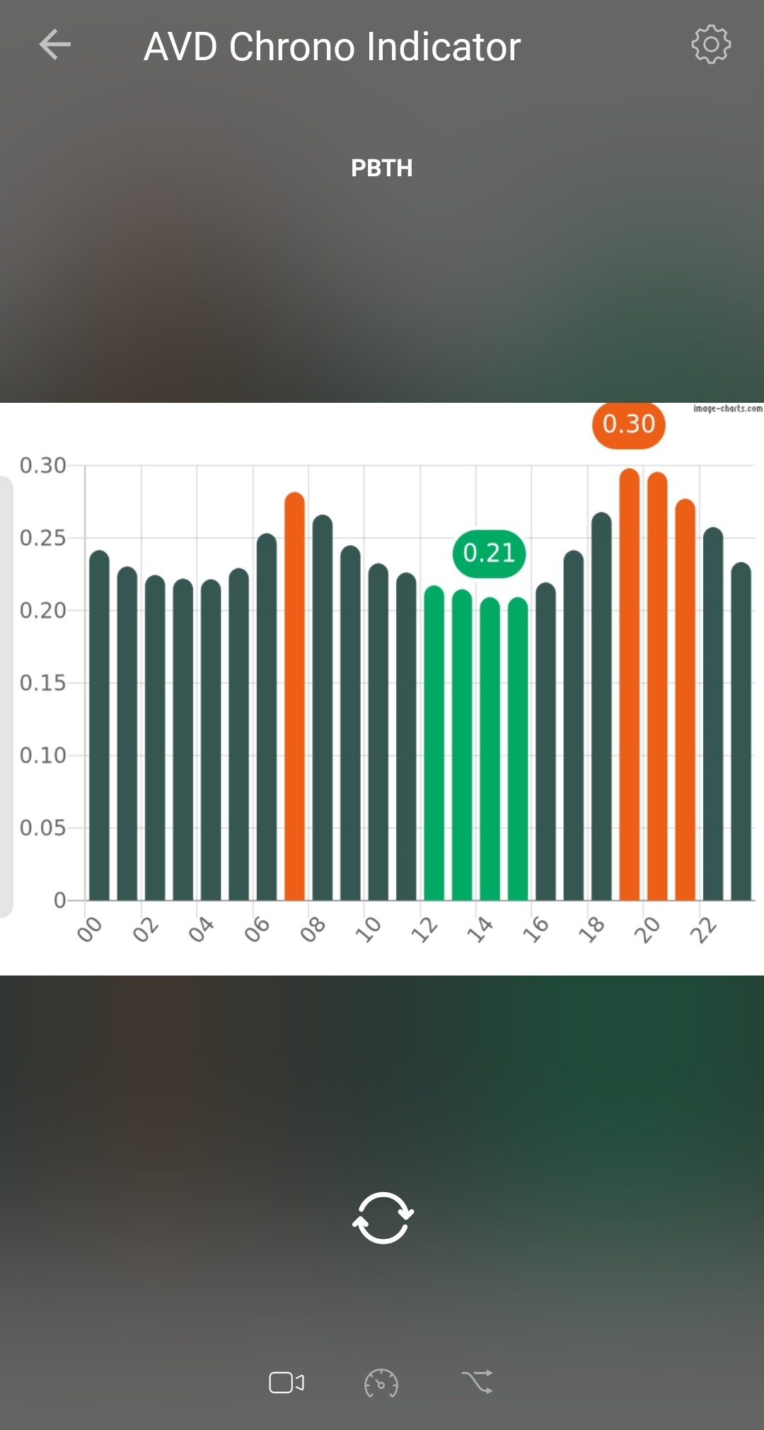

Is it possible to show this picture inside a device.
Like to see my solarpower statistics
You can start with this:
Pictures on Homey can be found here:https://tools.developer.homey.app/tools/images
Overhere, it’s looks like this:
When you open the picture in a new tab,
You can copy it’s URL, which you can use in a virtual camera:
Result
I managed to display the image in the device.
However, the Insight App generates a new url each time.
Would be better if I could use the image tag. This is because it adapts automatically.
