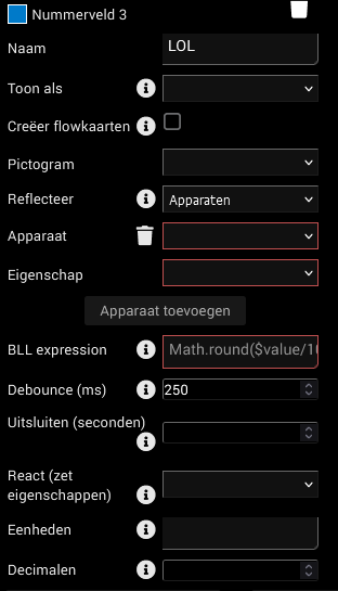

Well, just like everything in the AVD settings, i only show options that are applicable.
Thus, when you add a new numbersfield f.i., you get:
Just name, when you fill that, you get:
All reflect options are hidden behind reflect, and even it’s first loading of devices is behind it being selected. Saving resources, when you do not use reflection, it will not load anything extra at all.
When you Check Create Tag, another field appears:
This is how the whole settings work.

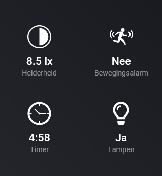

Okay,
I currently have/had 2 devices for each garden-part, one for sensor and one for lights.

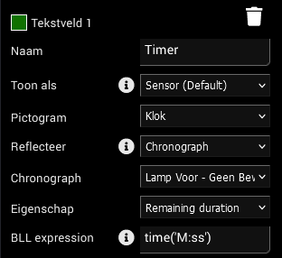

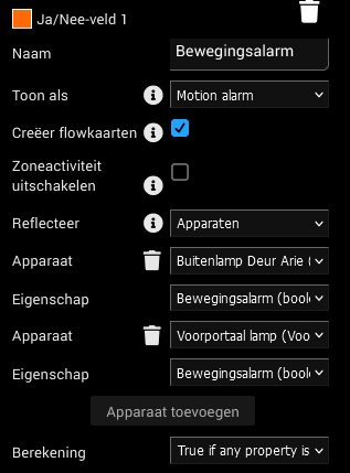

I now have created an AVD Called Front Light (Lamp voor):
This is done with the next fields:

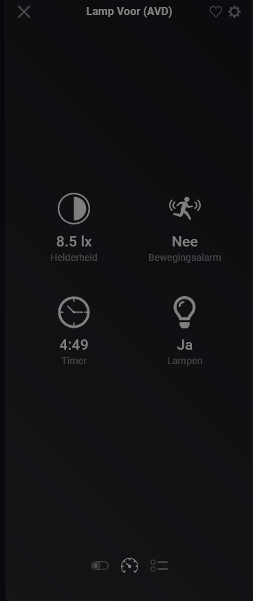

Finally, if the lights are not working, i dont have to goto Chronograph App Settings, then the Sensor Front, then the Lamp Front.
I can now open one device and have all the information in it, no flow needed :slight_smile:
Result:
and
I can push the button, and the lights are turned off/on.
