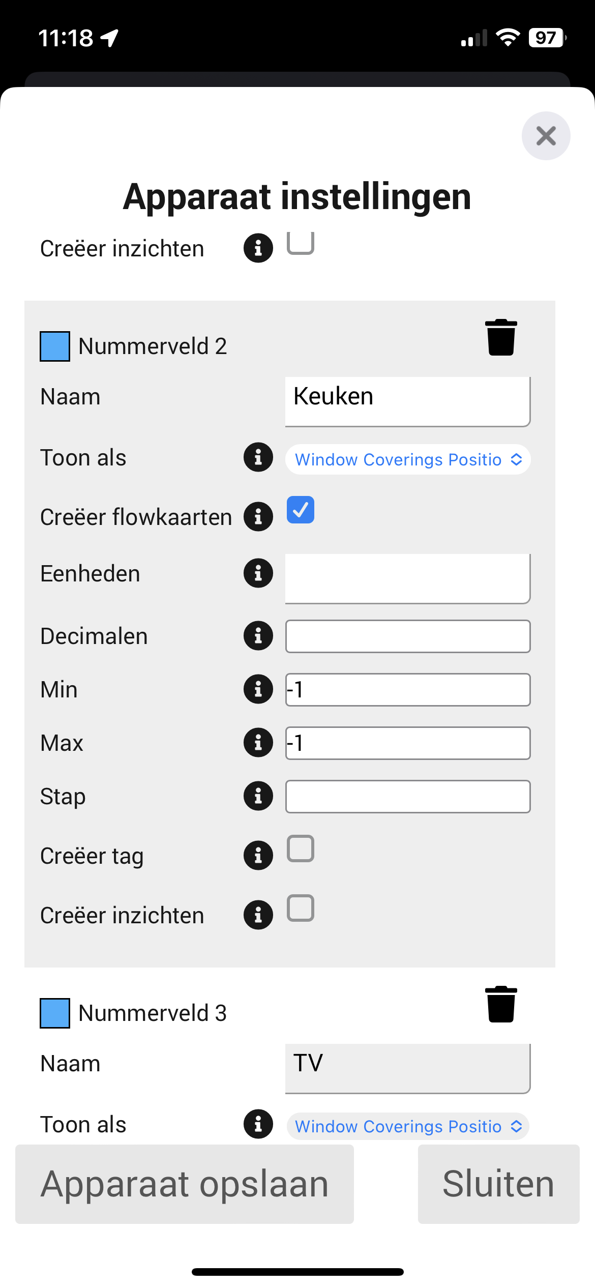

I’m trying to make some VD’s for my curtain and Sonos (like the OT)
But when it comes on to the volume slider or curtain slider i’m getting an error:
Can someone explain what i’m doing wrong?
Decimals not filled in, but can’t select -1.
I’ve searched on the forum, but could not find an answer.

Well, question: Why min/max -1 (this cause the error, nothing to solve on my end).
Remove the min max values, and the curtains should move as you are used.
