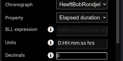

Brings me to another idea:
How about showing the formatted elapsed/duration time in the ‘Units’ field of the Numberfield, Arie? Is that even possible?
Then it can be showed on a status indicator of the mobile app tiles
Something like this:

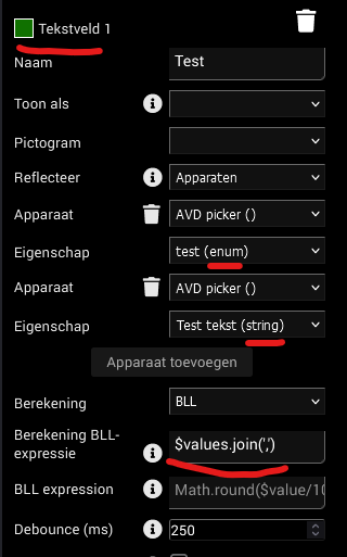

Part two of reflection: Devices.
You can now select (multiple) devices to be reflected on an AVD field:
Does it need further explaination?
This also works for all fields:
Okay, last update for today:
@DirkG and @Peter_Kawa Here is a practical example of part2 of Reflection:
I finally have created my AVD smoke-detector (part 1).
I have created one new AVD, added one filed (for now) with Smoke Detectors, set it to reflection:devices, and selected all my smoke detectors.
Now this AVD is automaticly updated if any smoke detectors change.
This works for all types of fields.
N.b. No real new loadings or anything has been build: this just uses the existing Watch-flowcard functionality plus other existing parts of DC; thus no extra performance required.
I will also be rebuilding my grouped Lux-Sensors with this: because this has an option to automaticly exclude device-values that are older then (setable) x number of seconds, f.i. 3600 seconds old.
So, if create an AVD with lux and group a few devices together with reflection, if one LUX is not being updated, it will be automaticly excluded.
This will be very handy, because sometimes my lights don’t switch on/off, because one of the lux-sensors in the group is not working. This will solve that.
