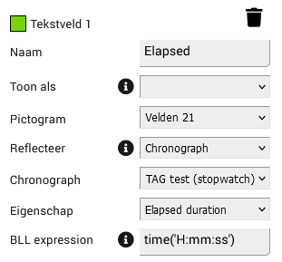

The text field:
Here i selected the same stopwatch.
I only added the BLL expression to format the time.

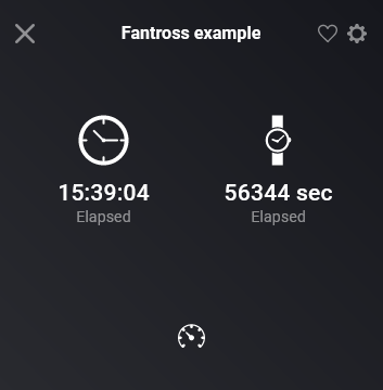

Result:

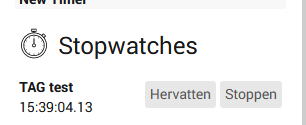

As soon as i press Pause or Resume on the Stopwatch in Chronograph, the AVD is updated.
No need for any flow!
All in test now:
