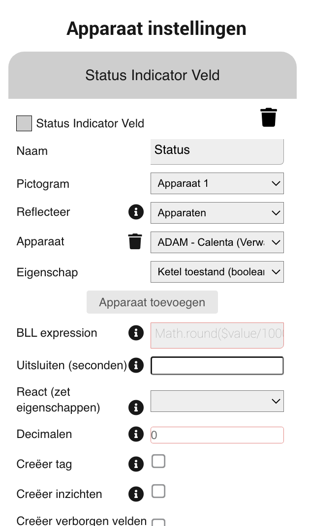

I managed to create a VD that shows the status of my central heating with the devices I would like to see:
(yes, the images are not done yet…)
How do I set the status of the CV on the actiual VD as status and have it show JA/Nee?
Schermafbeelding 2023-03-22 om 17.03.23
Is it done here:
It insists I do a BLL calculation
Don’t use the status field, use a yes/no or button field.
After that, you can select the field as status indicator in the HOMEY MOBILE app.
Hi Arie,
It is already a Ja/Nee field,
but it is not selectable in the App:
Created a ‘button’ too, but that also is not selectable as indicator.
Set the ‘device class’ to Other I guess.
Because when it is Thermostat or Light you cannot set the status indicator on the mobile device tile
Screenshot from 2023-03-22 17-55-03
Well, just for Yes/No right now:
You have it Shown as Sensor, which cannot be selected as Status Indicator:
For yes/no, to display the field as status indicator, it needs to be some kind of alarm type:

So, choose any other Show As for yes/no, and you can than choose it.
Also, but, the issue right now is using Show As Sensor, which cannot be selected.
Using Alarm (custom) or any other alarm will work (when device is other).

Simple yes no is not possible yet for status indicator.
