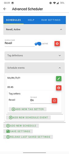

@Eric_Cosandey: Thank you for evaluating Advanced Scheduler.
To be totaly honest I am not really sure I understand your question. But I will try to explain. In the app settings you define schedules, and when they are suposed to trigger. Then in Homey flows (outside the Advnced Scheduler App) you set a flow card trigger to Advanced Schedule, nd select a schedule. Then that flow will trigger at all the times you have defined in the app. Does that make sense?
More details can be found here: Advanced Scheduler main help page | com.fp.advanced-scheduler
Feel free to keep on asking until there are no more questions!
@Eric_Cosandey What is the exact problem you are experiencing?
I’m going to guess you aren’t seeing the “Reveil” tag when having added the “Advanced Scheduler” trigger card into the flow?
When checking a tag within the flow: simply add a Homey Logic condition card into the flow and select the tag from the list shown (there, you will be able to find it).

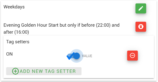

Hi
Just to be sure,
Will this schedule turn on After evening golden hour start and between 1600 and 2200?
What about the mornings
Here I want to turn on the light between 0615 and 0800 if morning golden hour has not started
First some background: Where I live (south of Sweden) evening golden hour starts earliest at 12:50 (mid December) and latest 20:22 (mid June).
First question (evenings): The schedule you have set up will trigger from February 21:st till October 30:th when golden hour occurs (again here in Sweden). After October 30:th golden hour will start before 16:00 and then the schedule will not trigger. Where I live golden hour never occurs after 22:00, so that part makes no sense in my case.

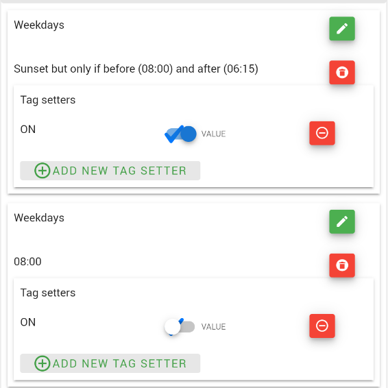

Morning
I would like to turn on lights earliest 06:15 and turn it off again at 08:00 but only if it is “dark”
Evening
I would like to turn on the lights when it gets dark and turn off again at 22:00
@Kongedam: You are close now. Evening seems 100% ok.
Morning I would do as you have done in the second trigger but change the first trigger to “Last of 06:15 and Sunrise but only if before (08:00)”.
I hope it works well for you! Keep asking if you have more questions.

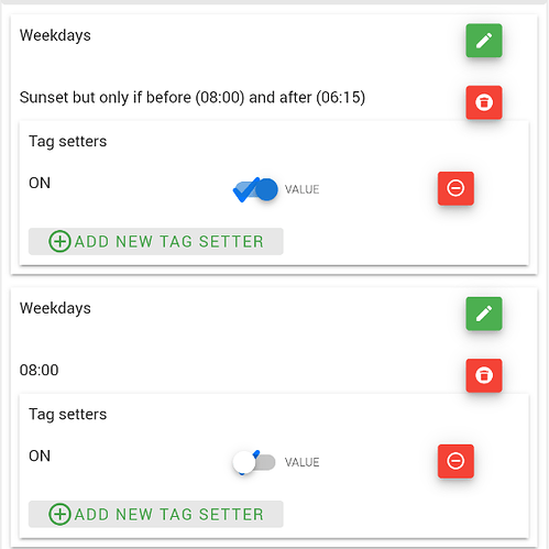

Thanks
I have now added it and will start testing it
Could you maybe try to add some explanation to this line ![]()
If my brain should interpret this line, then here is written
After 06:15
After sunrise
Before 08:00
What I want is
After 06:15
Before sunrise
Before 08:00
Update.
I Still don’t understand it, but it look like it worked ![]()
It triggered a little to late this evening, therefor I will try to use Evening Golden Hour Start
@Kongedam: Great that it works!
It is important to understand that there are no states in Advanced Sheduler. Everything is based on triggers/events. This means you cannot use “if sun is up”, “if sun is down”, “during morning golden hour” and similar.
The way to think is: Trigger at the first or last of x & y, but only if before/after z.
With this way of thinking I do beleive all scenarios can be handeled.
The algoritm to get a triggering time is as below (ignoring days of week):
- Take the time of the main trigger (the one that is always visible in the GUI).
- If there is a RANDOM time trigger specified, set the triggering time to a random time between the main trigger and the random time.
- If FIRST OF is activated, check if that trigger is before the triggering time. If it is, use that time as trigger, otherwise ignore and keep trigger time from above.
- If LAST OF is activated, check if that trigger is after the triggering time. If it is, use that time as trigger, otherwise ignore and keep trigger time from above.
- If CONDITIONAL BEFORE is activated, check if trigger time is before the conditional time. If it is, keep the trigger, otherwise remove trigger and don´t use it at all.
- If CONDITIONAL AFTER is activated, check if trigger time is after the conditional time. If it is, keep the trigger, otherwise remove trigger and don´t use it at all.
Hope this helps in future scenarios.
