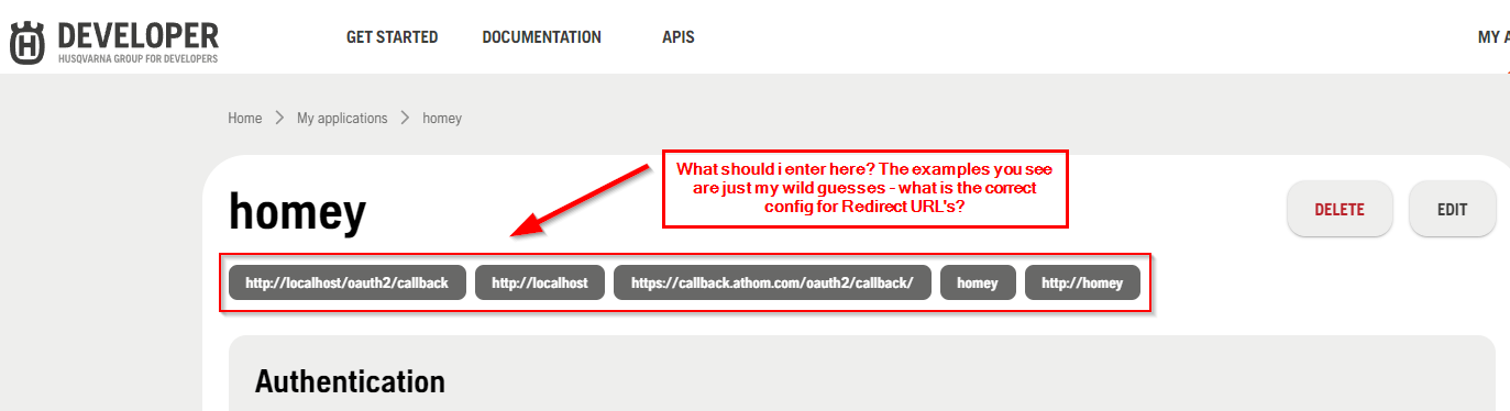

The husqvarna dev portal demands a Redirect URL, the field is no longer optional otherwise you can’t save the new application. This is probably an oauth redirect url? Does anyone know what redirect this app is using or what i should fill that Redirect URL field with?
I tried the a few url’s i found in some old homey documentation and code examples but they don’t seem to work: http://localhost, http://localhost/oauth2/callback and https://callback.athom.com/oauth2/callback/
For extra clarity: i can’t create an app within the husqvarna developer environment without filling out that Redirect URL field. But i’m not sure if it has anything to do with that actual 'Cannot read property ‘homey’ of undefined’ message i’m getting when trying to add a mower. I have 2 mowers configured in the husqvarna connect app, working well.

Thanks for the suggestion. I tried uninstalling, reinstalling and setting it up through the developer interface, but the problem persists. Is it possible to get some more information on how exactly your husqvarna developer app settings are done? Just to double check and exclude that as a cause.
https://developer.husqvarnagroup.cloud/applications
If you go to the settings for your application, what do you see in the grey boxes beneath your application name?
(my husqvarna application is named ‘homey’)

The only URL I have in Redirect URLs is this
Thank you for looking that up! I changed my app accordingly. Same result, but at least i’m sure that setting is correct :slight_smile:
