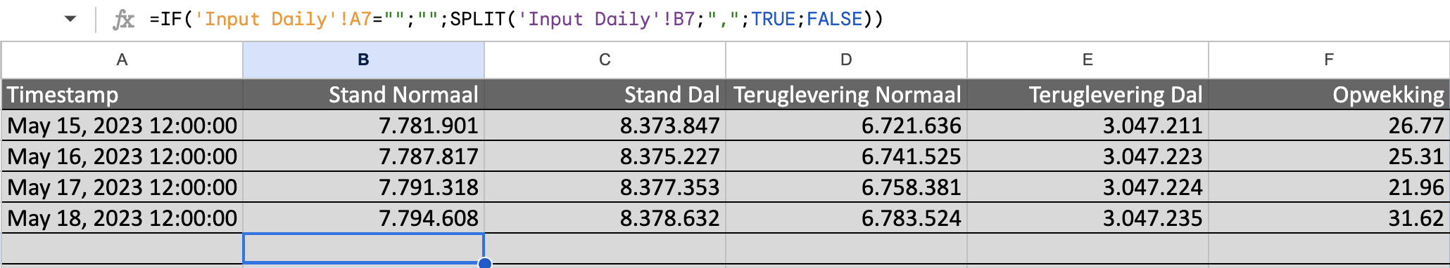

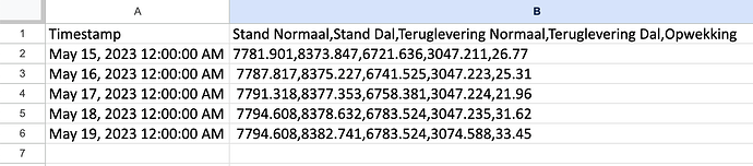

I have a question regarding the way Homey appends the data to Google Sheet.
Because I want to have multiple values in one line, I use a comma to separate those values:

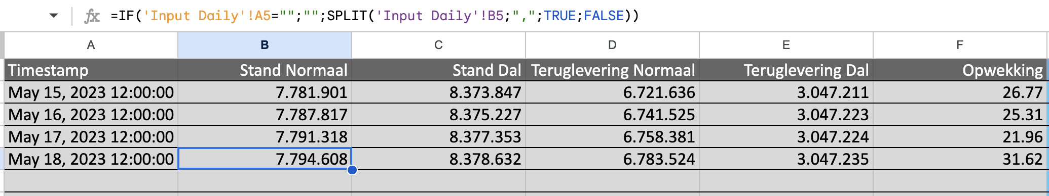

To get those values in separate columns, I use the SPLIT function in another tab:
However, every time there’s a new entry, somehow a whole row with formula’s is deleted. You can see this in the picture below. Instead of reading the values A6 and B6 (after A5 and B5 as shown in the picture above), it reads the values A7 and B7. This happens every time and because of it, I cannot see new data (in this case the data of May 19th) splitted up into columns:
My question: how did you solve this issue, or is this a bug in the app that needs to be fixed?

But unfortunately, all references to these fields are still adjusted/deleted when a new entry is listed, as shown in my example in my previous message.
don’t know if it is possible to use formulas like this, don’t even understand them, I store my values directly and that works for me.
Well, these were just to split the values, which I don’t need anymore. The IF statement is only there to hide 0.00 numbers when there is no data yet.
But next to these, I have very basic formula’s that calculate the daily usage by subtracting yesterdays value from todays. But if you put them in a separate tab with a reference to the fields where the data will be appended to, these formula’s get changed/deleted somehow. I don’t understand why this is, because they’re in another tab, so I would assume it should not be affected.
I presume you also make calculations based on the values you append to your sheet? How have you made these calculations? Maybe I’m just doing something wrong here.

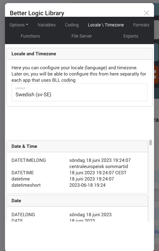

Not sure why Peter’s even replying if not to help. So Arie, please point me in the direction of the “date formatter”. I thought Homeys user base was mostly based in countries using 24h clocks, so it’s weird that its even set to 12h to begin with.
I’ve tried setting BLL Locale/Timezone to Sweden. Still getting AM/PM.
Yeah sorry, Google Sheets doesn’t support BLL coding (yet :wink: ), so changing those options only have effect on BLL supported apps.

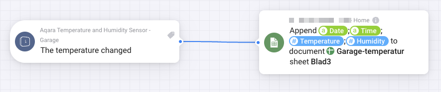

Could you share what and how you are exporting data to Google Sheets?
Because, with the limited knowlage i have right now, all i can think of, is that you add an extra column and add the datetime to it.
What you could do, is add the following flowcard, and include the resulting tag/value into the GoogleSheet when you append data:
These settings are for when you create your own Excel file through a flowcard of the BLL app, not for usage in Google Sheets :wink:
Or when you use the Excel generater in an app, like the Simple (Sys) Log app, or BLL itself.

Well, if you get the date from the dateformatter card, its considert a text, not a date, and you could just add it in those append cards. You would need to use AdvancedFlows tho, because you need to use the tag/token.
