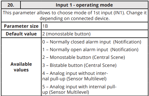

Smart Implant (FGBS-222)
Have an annoying behavior when using the Smart Implant as ordinary binary input where the symbol on the device indicate a constant active alarm, even when the digital input is back to low. I have toggled the parameter 20 between 1, 2 and 3, but no difference in behavior.
Anyone that have the same behavior and/or can answer how to reset the alarm?

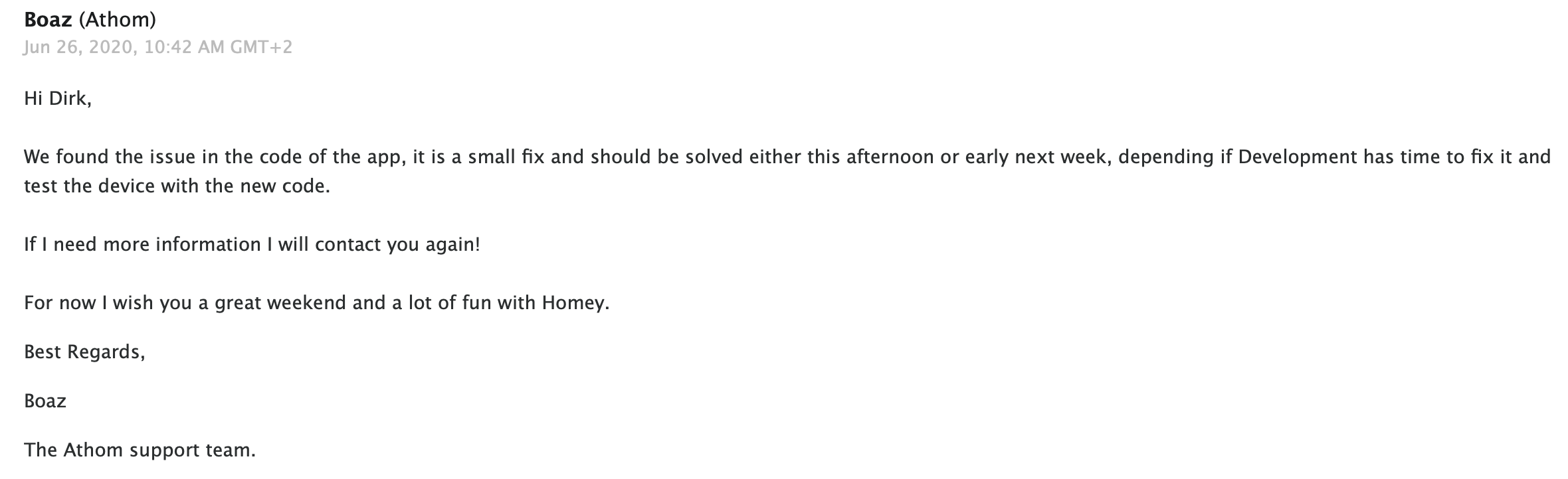

I am already in contact with Athom (Boaz) and hope for a quick fix. If Athom does not get the problem solved by Tuesday, I will do PTP.
An exclusion/inclusion of devices is the very last possibility for me.
@Murtaza_Biggy, this is the answer from Athom, so stay cool and wait a bit:
Thanks mate.
Actually they were fast. The new update is already out and I tested. Works fine now.
Thank you and thanks Athom (Boaz) for the quick fix.
