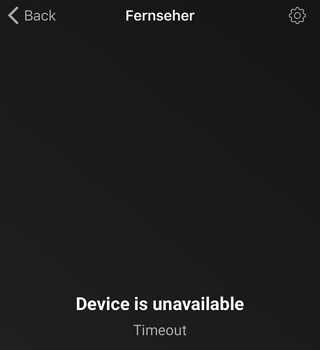

Anyone having the same problem? My fibaro devices are displayed as not reachable. See attached pics. Other zwave devices are working?! Any idea how to solve this?
I already tried:
  • app restart several times (+ enable disable)
  • homey w/o power for 15min to enforce mesh reset zwave
Only homey full restart helps. But only for about 2hrs. :frowning:
