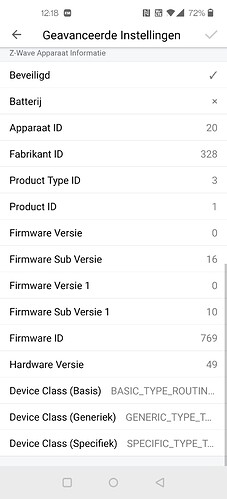

Today I noticed that with homey v5 the battery status no longer updates with the spirit plus Anyone else having this issue?
Same for me. “x” behind battery and no update of battery level for past 7 days.
The X behind the battery has always been there, that is just how Homey handles with FLiRS devices, and not the cause of the battery level not updating.
EDIT: Do keep in mind that the battery level (probably) only is send every 5% change, definitely not every 1%, it should send it every day if the setting is turned on, not sure if the level also needs to change enough for this.
If you do have an idea why the battery level isn’t updating after several weeks/months, i’m all in for more options, as it isn’t an app issue.
