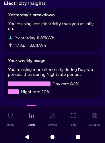

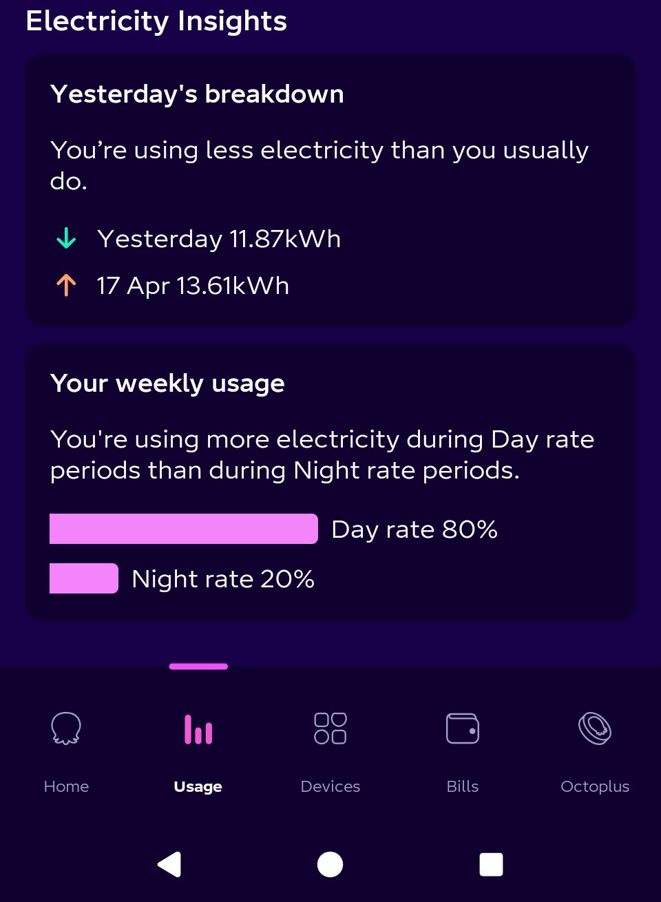

I’m quite happy to bank with them and keep the money in my interest bearing account. They haven’t ever asked me to pay it off. :man_shrugging:t2:
My actual timings are night rate is 22:30 to 00:30 GMT & 02:30 to 07:30 GMT. All other times are on the day rate. The octopus app thinks my night rate is a single block from 00:30 to 07:30 so always reckons I’m using more “day” electricity than “night”.
That is because it thinks my 1st 2 hour block is day rate & that block is probably half, or more, of the consuption of the storage heaters.
I went back to a random day in December. So winter & lots of power going into the storage heaters, but before I was trying to do anything remotely clever. The second image shows the block (& very wrong costing as a result) that the Octopus app thinks is night rate.

We’ve had E7, with various providers, since we moved into the property in 1983. In all that time,as far as I recall, we’ve had pretty much the same split period (22:30-00:30 & 02:30-07:30). We’ve been with Octopus since October 2021. I had read the link you posted &, when we had to have a new meter last year, as they were going to stop the radio control signal to the old one, I expected it to change to a single session. Nothing was said either way & it didn’t really bother me either way so it one of those things that just got left. I presume the meter must have had some input from Octopus to set the timing on the new meter.
The Octopus app assumes the 00:30-07:30 for its estimate of cost & just gives wildly inaccurate figures. I can confirm that the meter gets it right. When it shows the off peak only circuit is active all electricity from both circuits is charged off peak. I’ve checked the meter readings recently before the 1st slot (around 22:30) & after the 2nd (around 08:30) & total day rate consumption was 1 unit & 18 night rate. I was charging an EV, on a granny charger, timed to use both slots. So I would have known if I & the meter were disagreeing.
