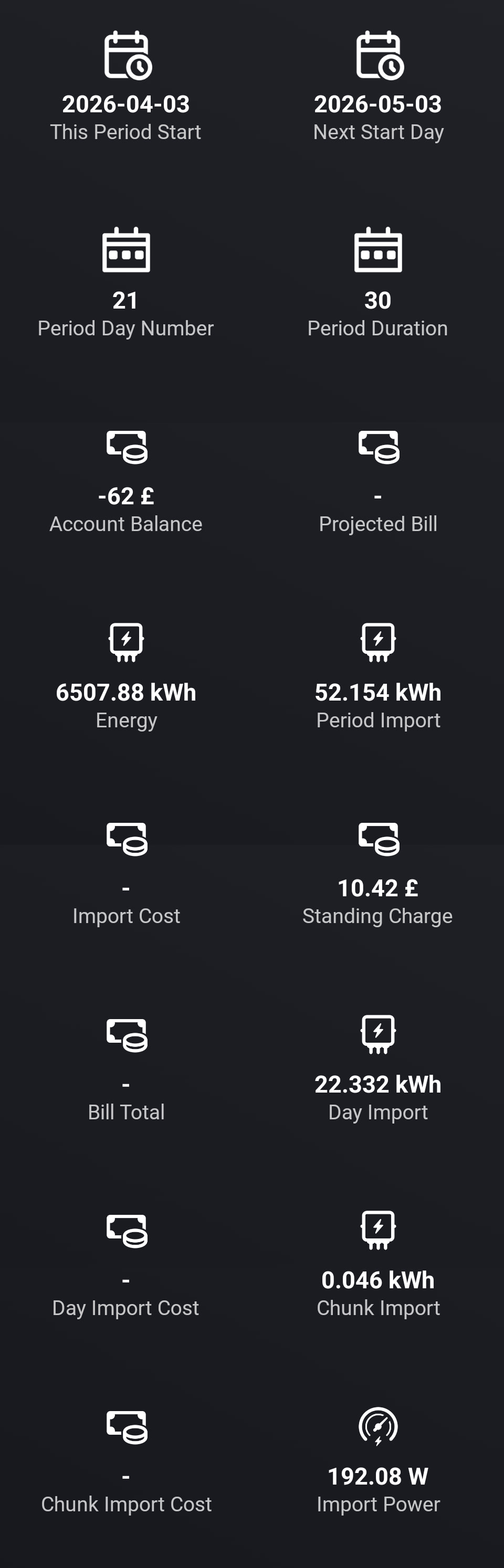

Here are screen-shots of my import and export tariffs (from my laptop). If your import tariff looks likes the IMPORT screenshot - that’s good news. If it looks like the EXPORT screenshot then there is work to be done in the app to sort out price changes.
These are what I’ve got. All the energy bits seem to tally reasonably enough with the Octopus app or meter. But there are no costs (apart from my slight negative balance :roll_eyes: as we come out of the “heating on” part of the year).
I note that the standing charge is included in the data in your app.
