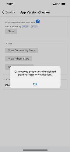

This morning I started a manual check. During the check the following error message appeared and the check got stuck:
Hmm, that’s a new one. I will look this evening.
