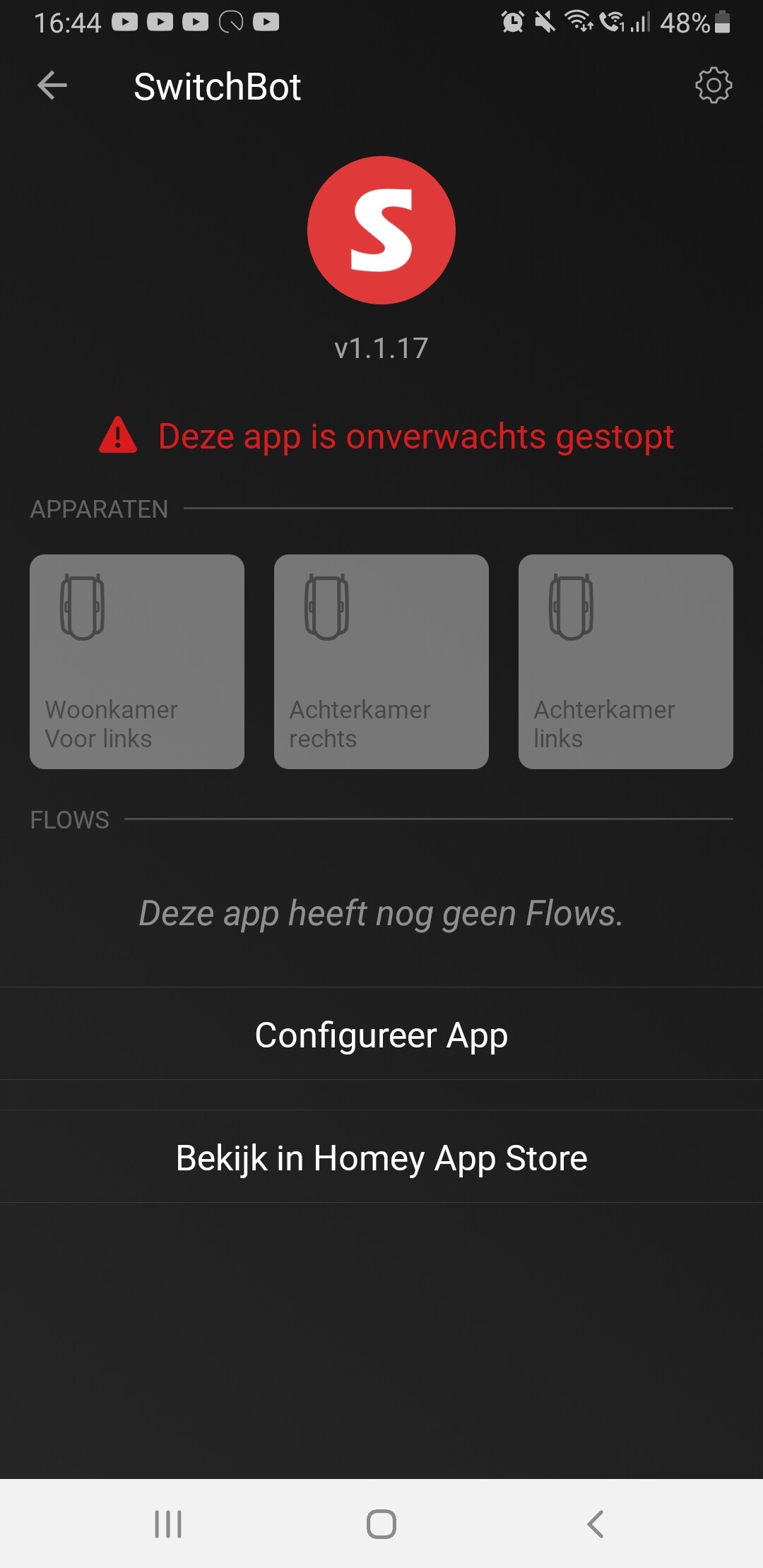

Another issue now. App has crashed twice in maybe 14 hours now. Had to restart app to get bot to work

After repairing or restarting the app, it works fine again.
Should all be fixed in the latest version.
Thanks Adrian, ur a star. I thought I had the latest version already. Just installed the test version. Hope it’s fixed :ok_hand:
