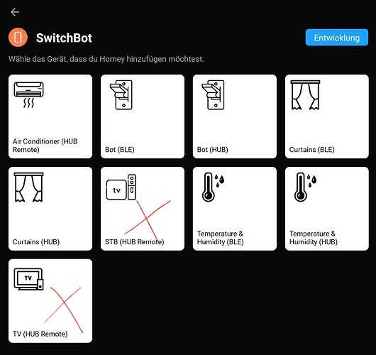

OK, OK TV I have alrawdy set up but The (apple TV) Icon of the STB and the name “STB (Hub Remote)” instead of “Set Top Box” in Switchbot made me not to recognize it on the 1st look.
Sorry.

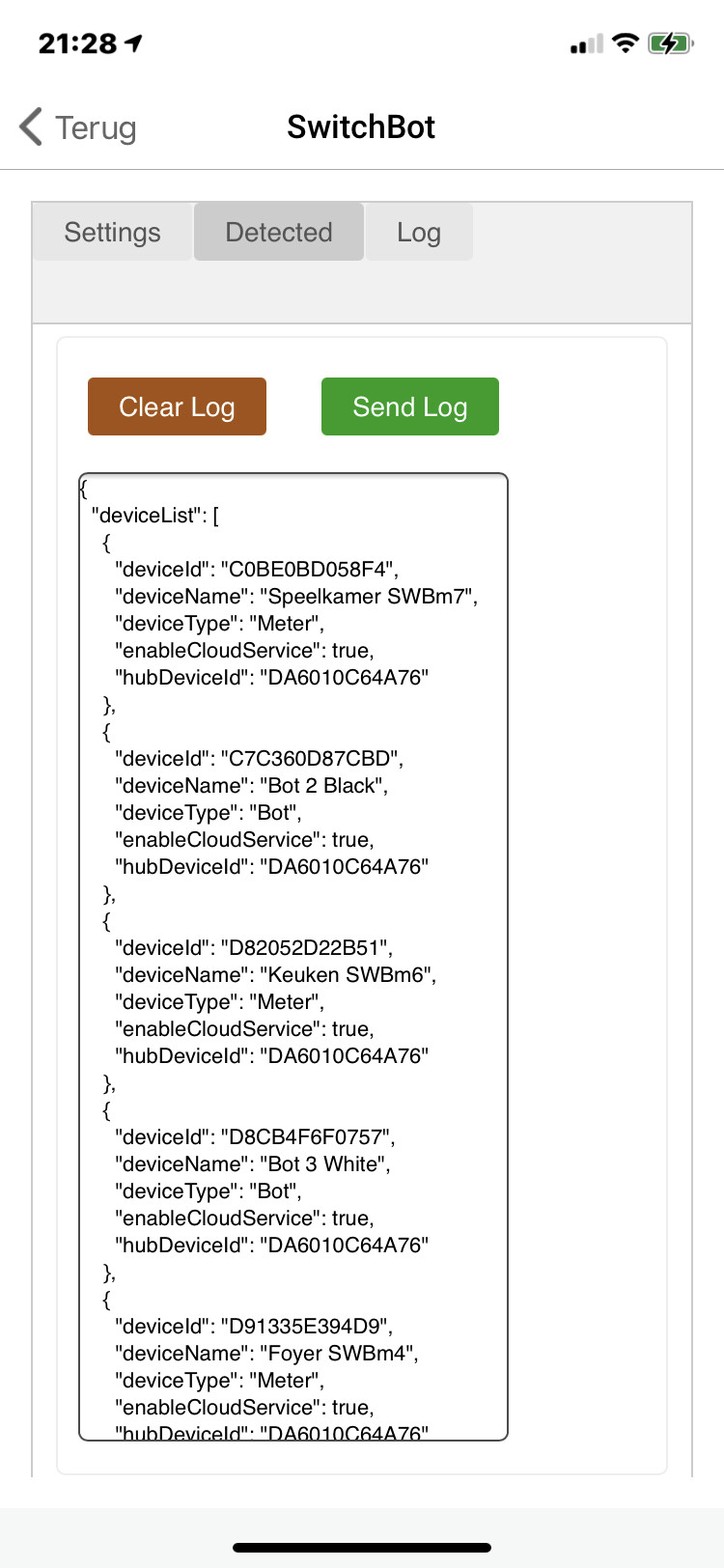

Could you go through the process of adding a device, even if you don’t have any that it finds. This will log the data that comes back from the list devices API. Then go to the More - Apps - SwitchBot - Configure App - Detected tab and click on the Send Log. That should let me see what the deviceType is for the devices you have add to the SwitchBot app.
Then I can make sure the app knows what to look for.

I’pushed on send log a couple of times but don’t know if it dig send anything. Maybe a confirmation for that button if tis send would also be useful.
When you press the button it should confirm you want to send the log and then you should see a busy timer and finally a confirmation or failure message.

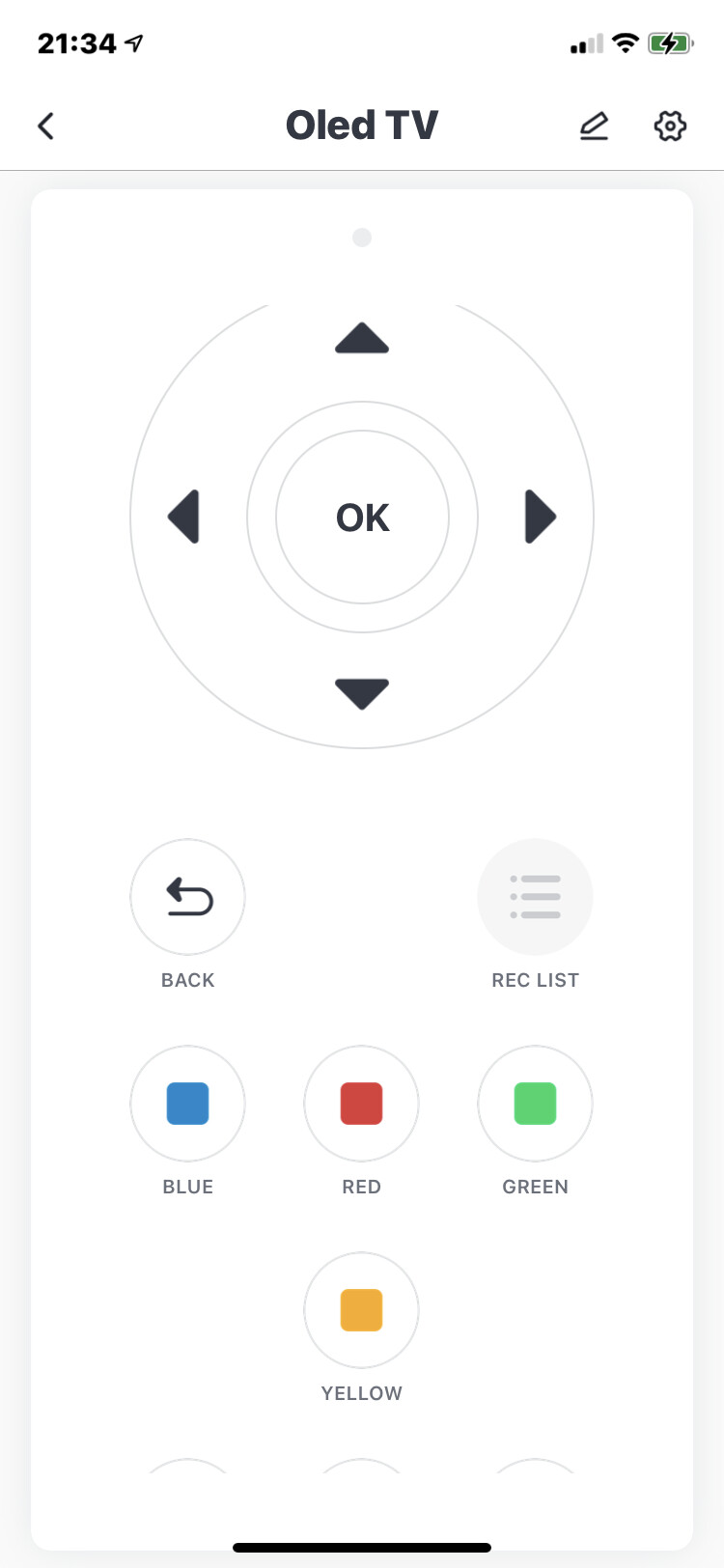

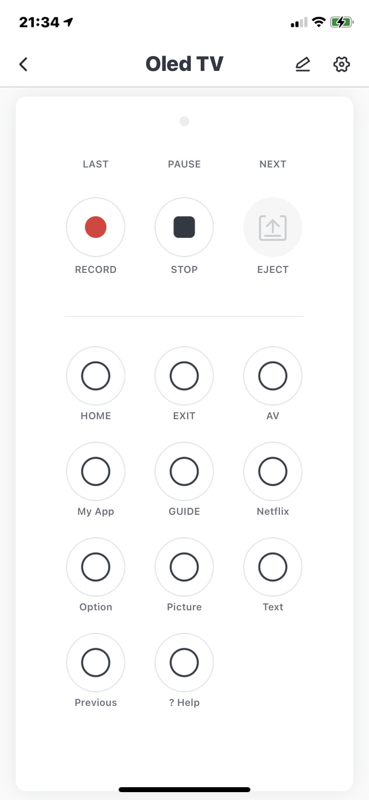

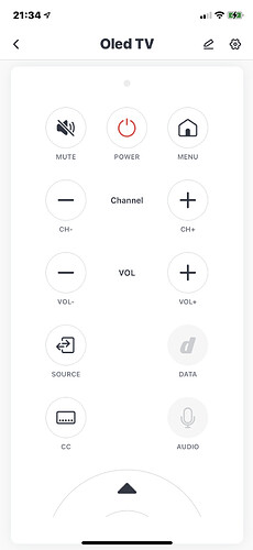

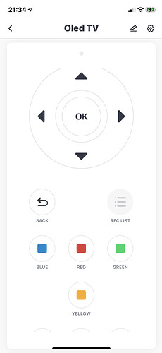

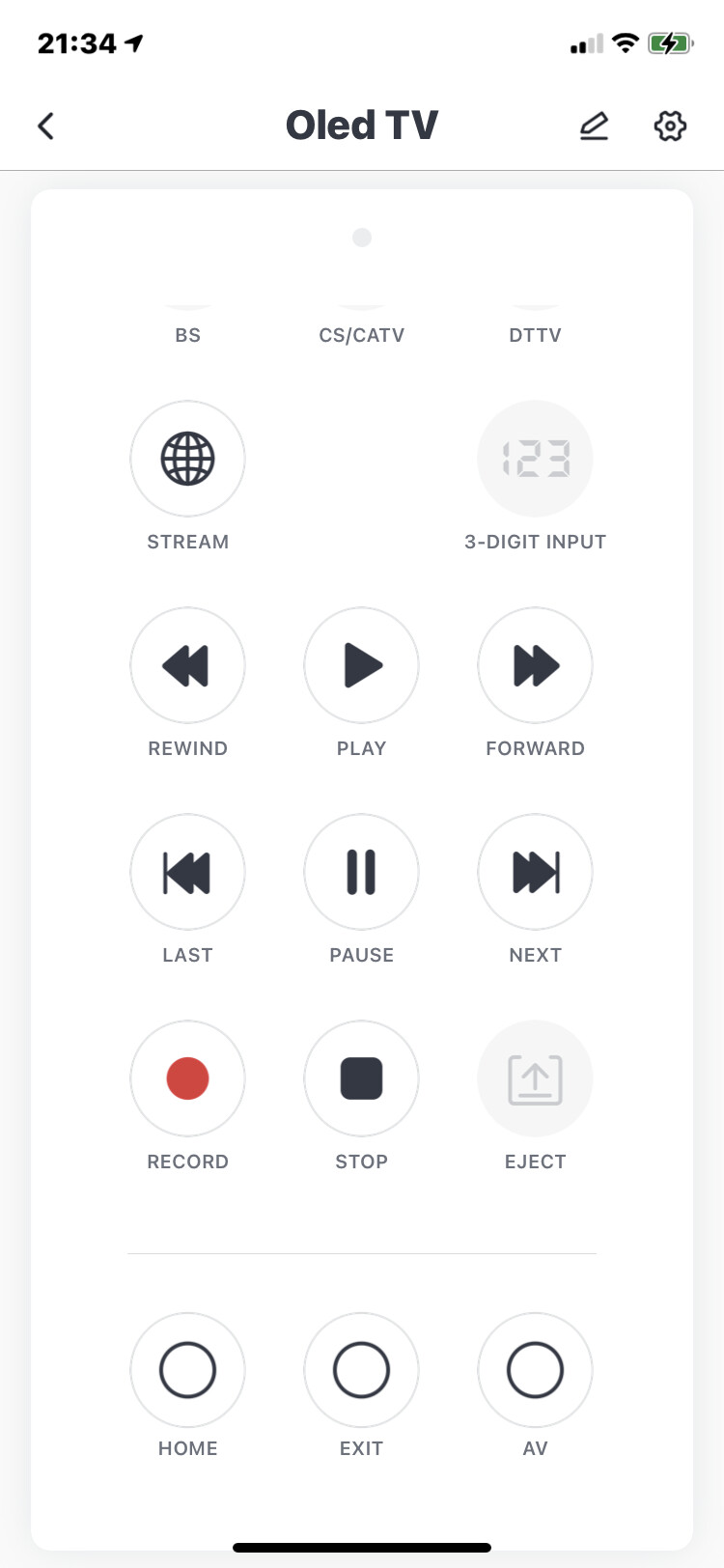

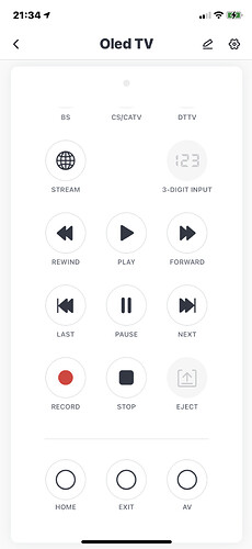

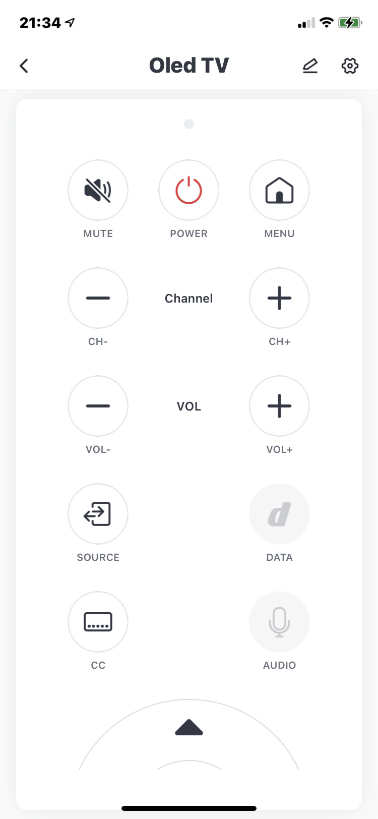

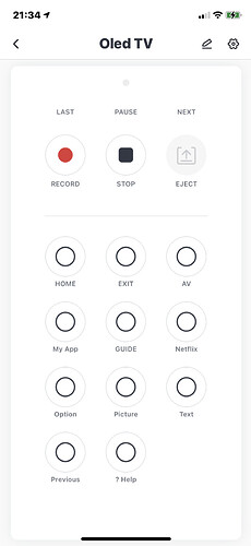

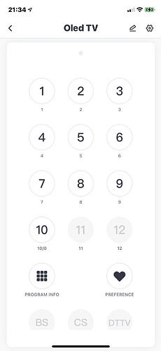

These are all the configured (custom) ir commands I learned/thought SwitchBot from the original Panasonic OLED TV.
The grey(ed) out buttons are bot functional/configured.
The round buttons at the bottom I’ve added and are all custom from the original remote.

Yes please, update to the test version as I can’t remember when I added the extra bits.
Just updated to 0.32 &
have send a log.

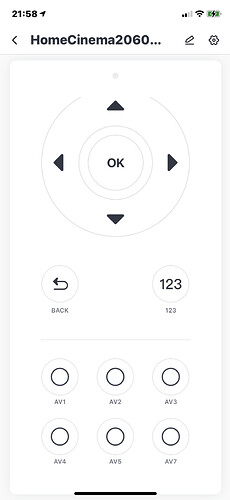

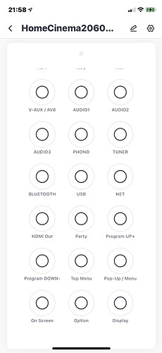

And here is my Yamaha RX-A2060 receiver added to Switchbot as an IR Speaker device :

I have added the speaker and DVD devices so I can check the speaker against the log.

The DVD and Speaker remote devices just have the buttons that are published in the SwitchBot API.
I will keep think about ways to add the custom buttons.
