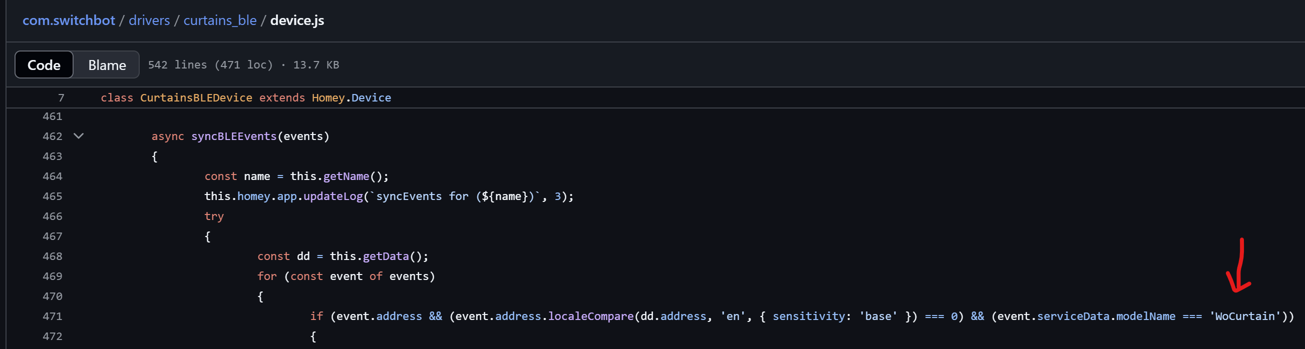

I am just wondering whether the following in the SwitchBot app might cause the issue. I have very little knowledge of JavaScript, so bear with me…
If I am correct:
  • The device’s syncBLEEvents function plays a role in processing status-updates from the curtain motor.
  • The device code used for my Curtain 3 is in curtains_ble > device.js
  • The syncBLEEvents function in this device.js checks for ‘WoCurtain’ as model name before processing the received data.
  • My Curtain 3 motor has a different model name: ‘WoCurtain3’.
  • Since the model name does not match, the function is not executed further/data is not processed.

I managed to get rid of the ‘Invalid response code: 500’. I used your binaries, which I initially couldn’t flash. But after changing the SPI mode to DIO instead of QIO, my ESP32 was able to boot. Somehow the 500 errors do not pop up in your compiled binary, but do show up when I compile the code myself.
I also learned that the 500 error was a result of the ‘callback/add’ and ‘device/write’ requests by the SwitchBot app. Though the error popped up, the ESP32 actually was transmitting updates to the SwitchBot app. When I compared the logs based on their timeline, I could see the ESP32 sending updates when the curtains moved. And I also saw the same info being received by the SwithBot app (syncEvents messages).
What (still) does not work is the actual processing of received updates by the SwitchBot app on Homey. I believe this is caused by the syncBLEEvents function in drivers / curtains_ble / device.js.
This function checks for ‘WoCurtain’ as model name before processing the received data:
if (event.address && (event.address.localeCompare(dd.address, 'en', { sensitivity: 'base' }) === 0) && (event.serviceData.modelName === 'WoCurtain'))
My Curtain 3 motor has a different model name: ‘WoCurtain3’. I assume that since the model name does not match, the received data is not processed.
Could you please verify this?
Thanks for your help.
That would make sense. I will look into it and publish an update.
I have publishes a new test version that accepts WoCurtain3 as well.
P.S. Well done for tracking down the issue.
