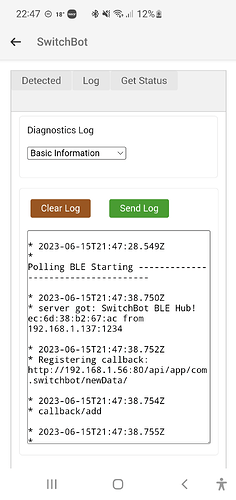

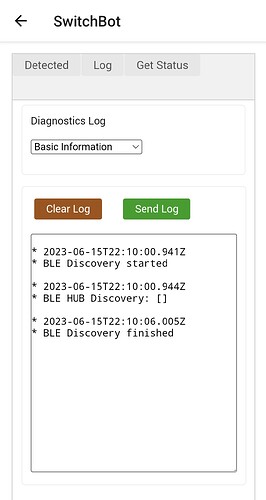

If you look in the App Settings page at the Log tab do you see a message for the BLE hub detected?
You might need to restart the app just to be sure.
Tried and here’s the log.
also received an UDP request:
UDP Packet: , Data (len 24): Are you there SwitchBot?
Received: Are you there SwitchBot?
It seems that the HUB isn’t seeing the Switchbot too? (it does work from the original app on the phone though)
