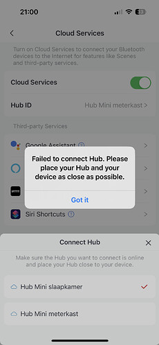

are they people here who have issues with they curtains? they don’t react to homey commands. I switched it from hub mini, but no effect. also when I want to switch Back to my bedrooms hub it give’s a connection failure.
PS: I know this is probably not a Homey related problem, but wanna know if there are more people who has this problem. (in the switchbot app, I think via BLE the curtains move perfectly. when Im not home the failure most of the time with finding connection)
( everything is on the newest firmware, I restarted the hub mini’s, my wifi. but with no results)
Under the cloud services for the curtains you can select which hub controls them. Have you selected the one that’s nearest to the curtains?
Yes i know but thats wat the curtains wont do, he connects fine to the other hub mini (meterkast)
When i test the hub mini bedroom (slaapkamer) with its light turn on and of it reports very quickly in the switchbot app. So it seems its connected
I think you need to report it to SwitchBot via their app so they can verify the hub is working OK.
just done that, didn’t know that that was possible. thanks for the help :+1:
strange thing is that it also doesn’t work when it says it is connected to the other hub mini. (not working via homey at least)
