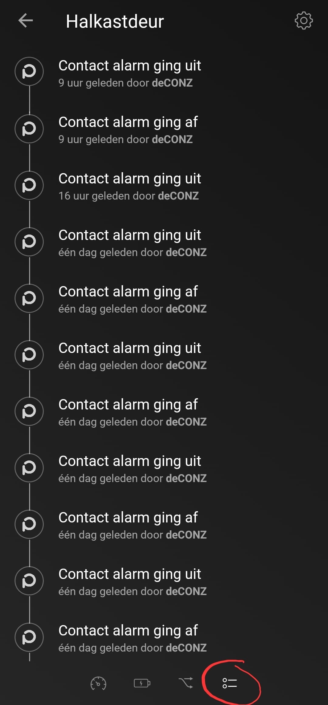

Hi! Thanks for this app… One thing I’m missing is device history in the device settings… Is this something that can be added??
I’m not sure what history you are referring to. There is no mention of it in the SDK so probably not.
I mean this by example:
At the most right tab of a device you can see what and when the device has turned into to and how.
Thats already there:
Aaaah sorry, forgot to mention… I’m talking about the Switchbot curtains.
Ah, those entries only work for boolean values and the curtains use a numeric position so can’t be shown there. It’s a limitation of the Homey interface.
